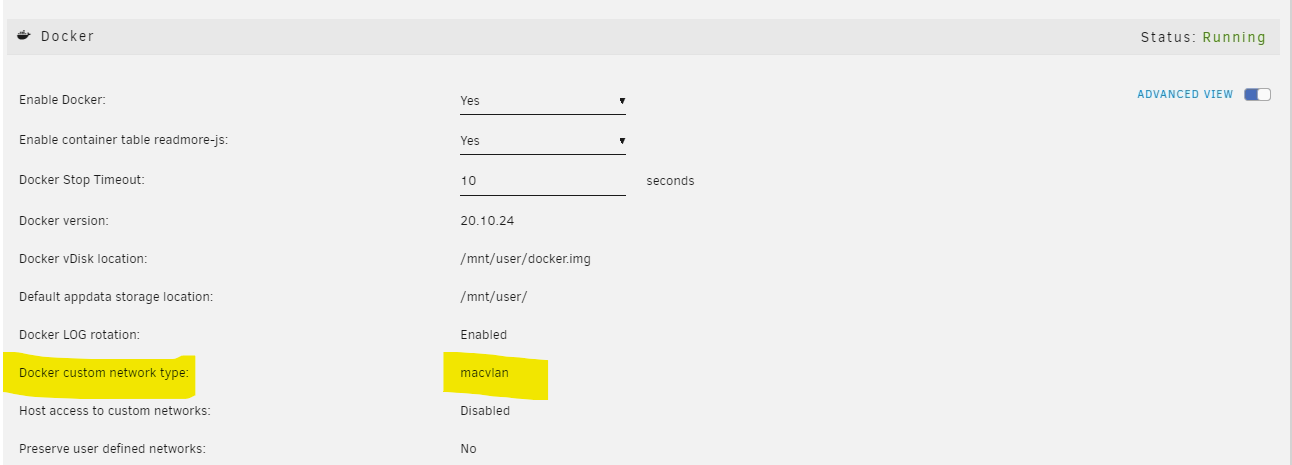

taflix Posted December 29, 2023 Share Posted December 29, 2023 SUGGESTED FIX: Macvlan and bridging has been found. This might cause issues with stability on your server. More Information Going to that link, it says: Quote If you are getting call traces related to macvlan, as a first step we recommend navigating to Settings > Docker, switch to advanced view, and change the "Docker custom network type" from macvlan to ipvlan. But the option is READ-ONLY? Help, please? 1 Quote Link to comment
Danilo Graziano Posted December 29, 2023 Share Posted December 29, 2023 I have the same warning and the same read-only limitation 1 Quote Link to comment
Solution itimpi Posted December 29, 2023 Solution Share Posted December 29, 2023 21 minutes ago, Danilo Graziano said: I have the same warning and the same read-only limitation Have you stopped the array first? 1 Quote Link to comment
taflix Posted December 29, 2023 Author Share Posted December 29, 2023 13 hours ago, itimpi said: Have you stopped the array first? Thank you! Stop array. Then, follow instructions. Start array. Rescan for errors. No errors found. Yay! 😄 The "stop array" step should be included in the instructions. Quote Link to comment
Raider.VE Posted December 30, 2023 Share Posted December 30, 2023 (edited) You can also just disable Docker (first entry in picture: Enable Docker -> No) and reenable it after changing any setting (Docker will autostart as set) For some cases you need macvlan, if that's the case for you (+ there are problems using macvlan and Bridging) -> https://docs.unraid.net/unraid-os/release-notes/6.12.4/#fix-for-macvlan-call-traces Edited December 30, 2023 by Raider.VE Macvlan and Bridging might just work, despite the warning Quote Link to comment
Techspin Posted February 20 Share Posted February 20 (edited) You must also be in Advanced view to even see the entry. It would be great if support for fixing issues could be given in clear step-by-step instructions readable by less tech-savvy users, as the current link is not helpful enough for me personally without this instructive post from @taflix Thank you buddy! Edited February 20 by Techspin Quote Link to comment
