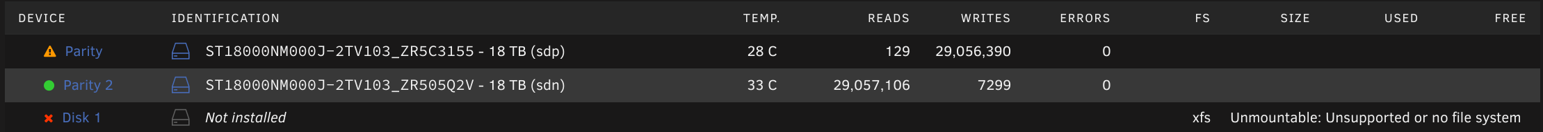

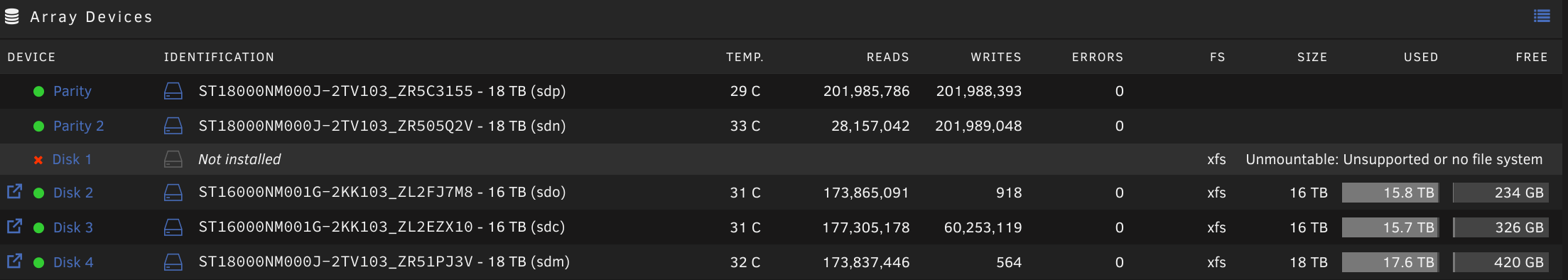

I've waving the white flag on this one. I've pulled the unreadable disk1 and will try UFS explorer to salvage whatever data I can from the drive. Of course I didn't have backups, I kept putting off a backup solution...lesson learned the hard way.
Currently I have an empty disk1 slot and I've running a parity-sync since the other disk that went red X was a parity drive. Though unRAID seems unhappy about a missing disk1. It says it's unmountable and has the format option. Does unRAID just dislike having array disks out of sequence?
ADDENDUM: Actually since the other array drives seem ok, should I put in a new config then run a parity-sync? It seems like running a parity-sync now would just perpetuate the unmountable disk1 error.

image.thumb.png.9aca17f25e8a3626a8e8928b79b5c4ed.pngimage.thumb.png.9aca17f25e8a3626a8e8928b79b5c4ed.png
Disk1 is the drive that showed errors. Parity 1 also had a red X but I rebuilt it. Which was prob unnecessary since the disk1 red x is still there. This was all triggered when I added two new drives to be precleared. I had a 450w PSU which was probably woefully inadequate. I've replaced my system with a 650w and I have 2x 20tb ready to go in as new parity drives.
It seems like the best scenario to removed the red x on drive 1 and ensure data corruption is to do the following...
