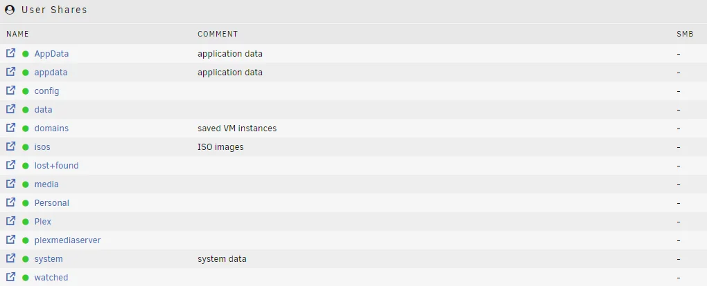

I just got around to setting up unRAID for the first time after posting about switching from OMV. I followed a mini-guide of sorts (https://www.reddit.com/r/unRAID/comments/xdkxjr/comment/ioc22sk/?utm_source=reddit&utm_medium=web2x&context=3) which seemed to work well. The problem I'm running into is creating SMB shares where unRAID fails to load any shares (no error, just no results returned).
I didnt input any credentials or domain, and this is what the shares currently look like. Not sure where to go from here.

Solved by itimpi
The picture shows that they aren't exported.  The share you need to export via it's settings.
Also, FWIW you've created a top level directory (ie: share) via a docker container called AppData and appdata.  Not an issue per se, but rather confusing.  You should see which contaiiner has the "appdata" share and fix it to match the case of the default one (it's going to be one that does not have a "/config" for one of its container paths.

If you want a share to be visible over the network then you need to change the Export setting under SMB to something other than the default of No.   which value you select depends on your security needs.
Linux is case sensitive for folder/file names whereas SMB is not.   Therefore if you have two folders at the Linux level with the same spelling but different case then only one of them will get picked up by the share with the same spelling.

What is the difference between that and setting it up under Main > SMB Shares? Considering I need to clean up (ie remove) a lot of the existing Shares, is it best to do this via CLI or is it possible via the web GUI?
28 minutes ago, Goofyman23 said:
Main > SMB Shares
You must be referring to the Unassigned Devices section and the SMB share feature of the UD plugin. This isn't related to your Unraid managed User Shares.
In the webUI, you can remove a share after you delete all its files and subfolders.
I recommend Dynamix File Manager plugin and not trying to use cli for file management. You can get into trouble with the cli if you aren't experienced with Unraid.
