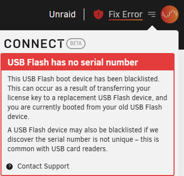

Hello, Unraid started reporting that the USB I have been using since start for boot is blacklisted. Its a Samsung flash drive so I am not sure why it would be missing serial number. Is there a way to fix this? it also shows error that the flash is corrupted or offline.

Try rebooting using a different USB port, ideally USB 2.0, if it's the same you will need to replace it.
will the server start normaly even if rebooting does not solve the issue? if it does not help do I need to just copy the files to a new usb flash?
It should boot but the array won't start if a valid key/GUID is not found.
