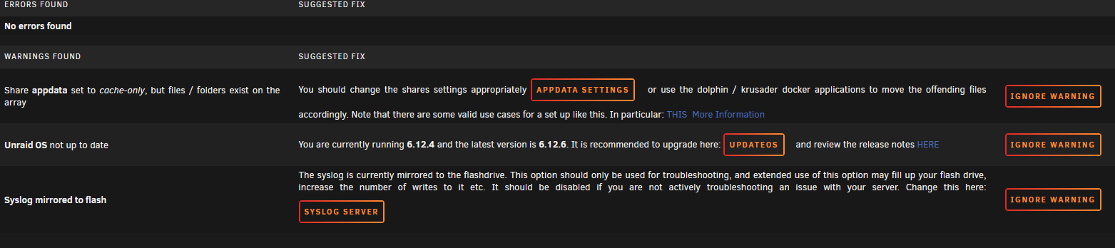

Fix Common Problems:
Spoiler

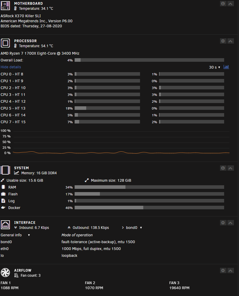

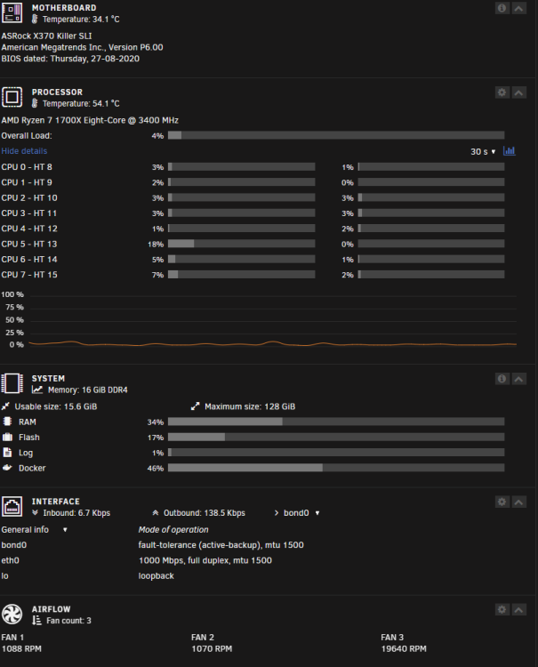

My system hardware:
Spoiler
  • NVIDIA GeForce GTX 1050 Ti
  • Machine runs headless
  • No VMs
  • Some Docker containers
  • No overclocking
