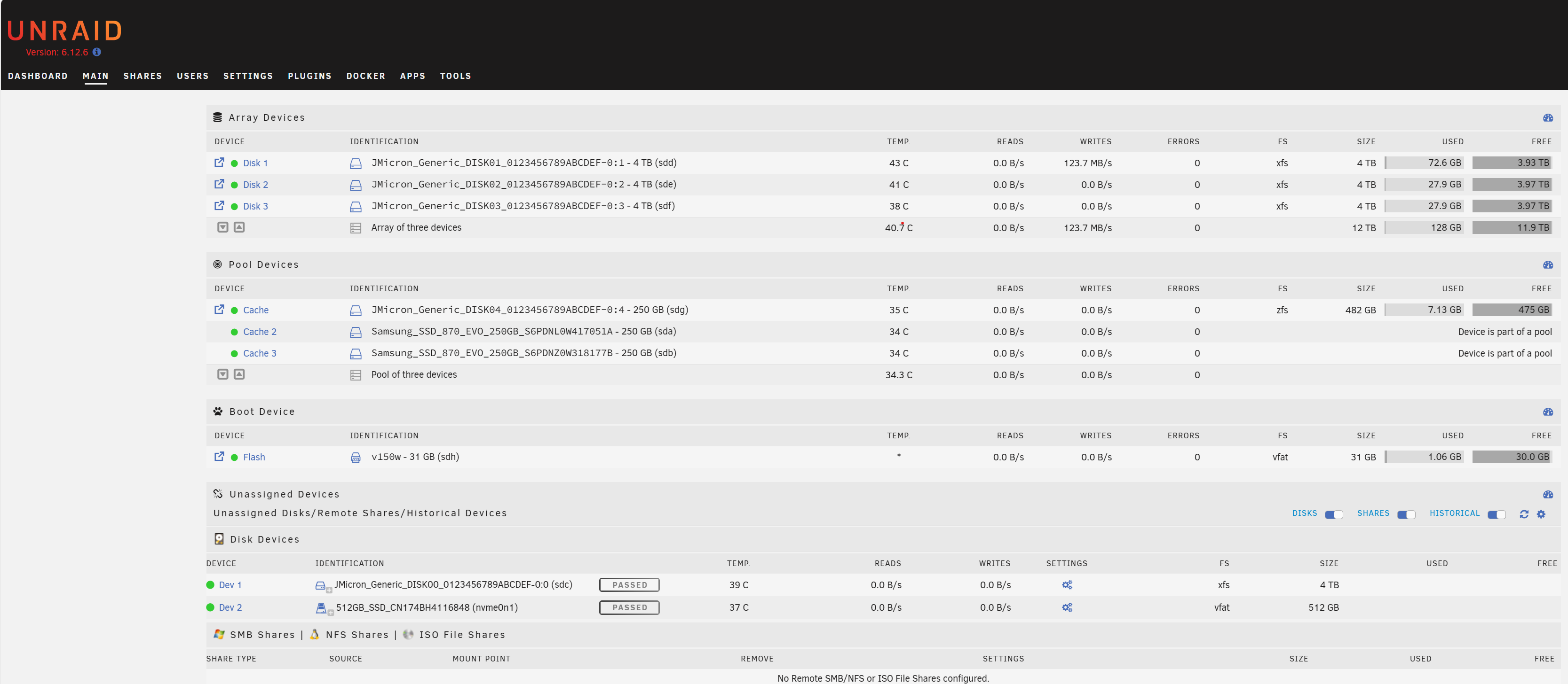

For reasons completely unrelated to the network performance issue, I am totally rebuilding my disks with data (no parity while the data is being transferred).  The data is coming from my main Windows 11 PC and being written to the mini pc as an Unraid server.  Here's a screenshot.  You can see the data transfer rate is 123.7, which bounces around some based on the file size.  Clearly this is only transferring at 1.0 gb, not 2.5 gb.  I know I'm not getting the transfer rate I should be.  Running another test will only confirm the problem.  I'm hoping for a solution!
