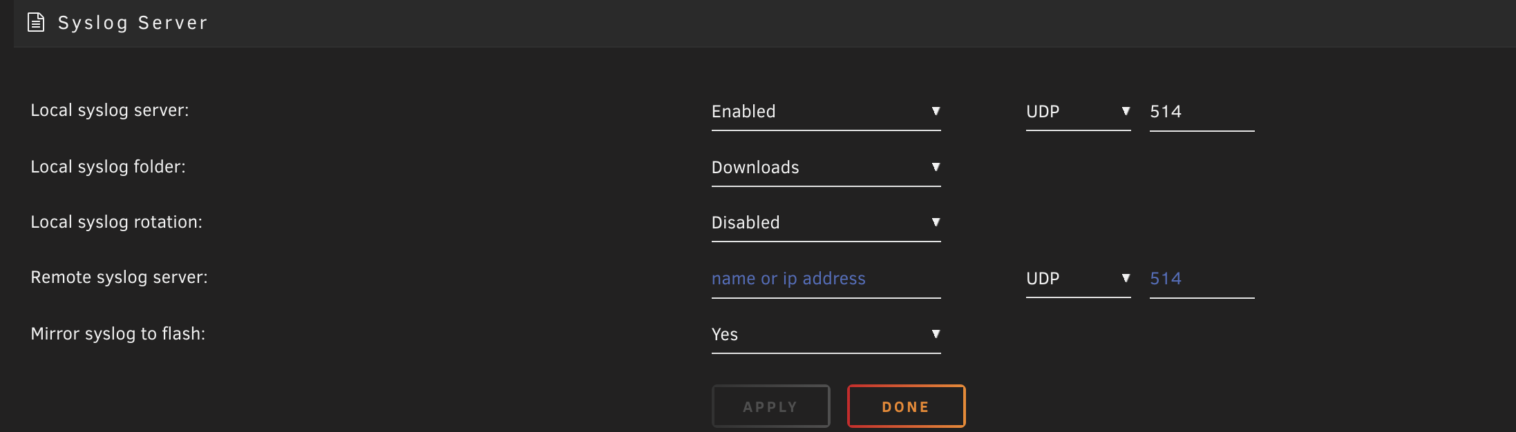

Setup syslog server
Is this all I need to do to get syslog going?
Yes.   That will result in the file being generated in the ‘logs’ folder on the flash drive.
