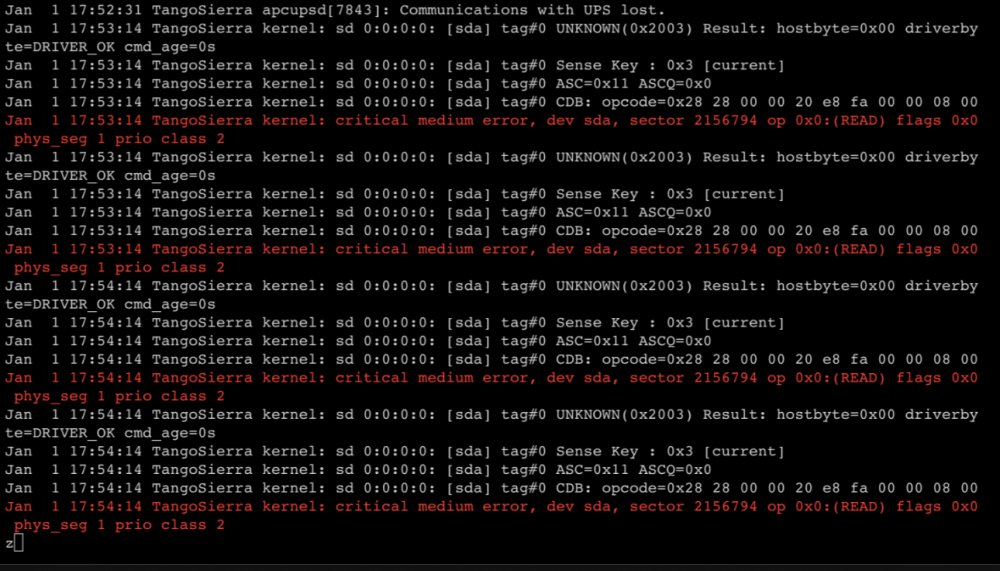

I have a been using Unraid for quite some time. Over New Years weekend I decided I would rebuild my old Haskell i7 server with a Raptor Lake i7.
Since the rebuild the server has not been stable.
I have noticed the attached error appearing in the logs.
I would appreciate any help you guys/gals can provide.

You are having flash drive issues.

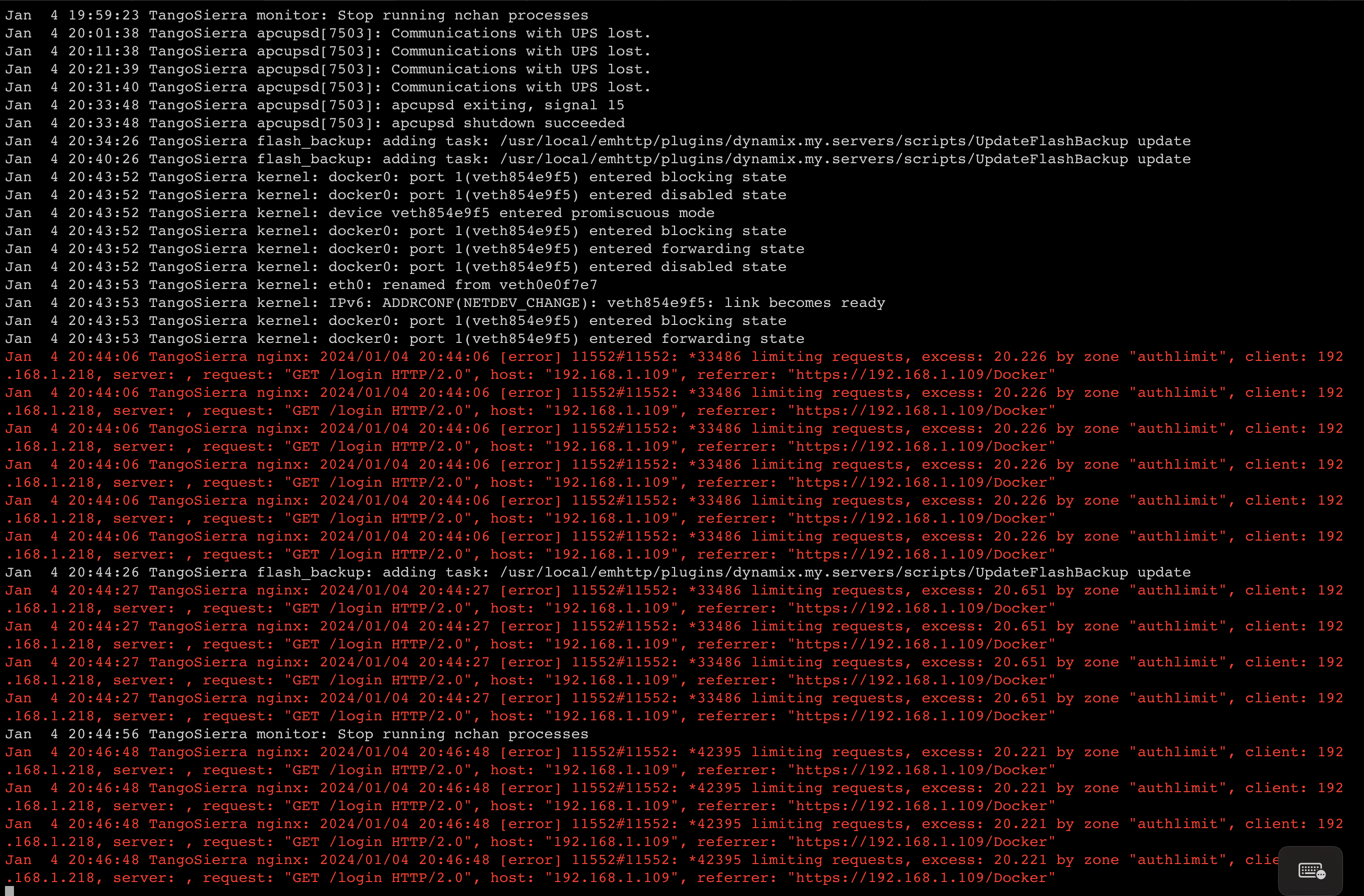

@JorgeB, I replaced the flash drive and everything seemed to be okay, however the system crashed again today.
There are new errors in the log, and I am not sure if the flash drive I used is causing them. The original drive I purchased was not supported by the disk creation utility, and I ended up having to use a drive I had lying around…
I appreciate your help as always Jorge.
tangosierra-diagnostics-20240104-1926.zip
Change Settings for Docker from macvlan to ipvlan
I have done this in the past. I believe when the system crashed it reverted. I went back in and corrected that issue.
Additional log errors:
