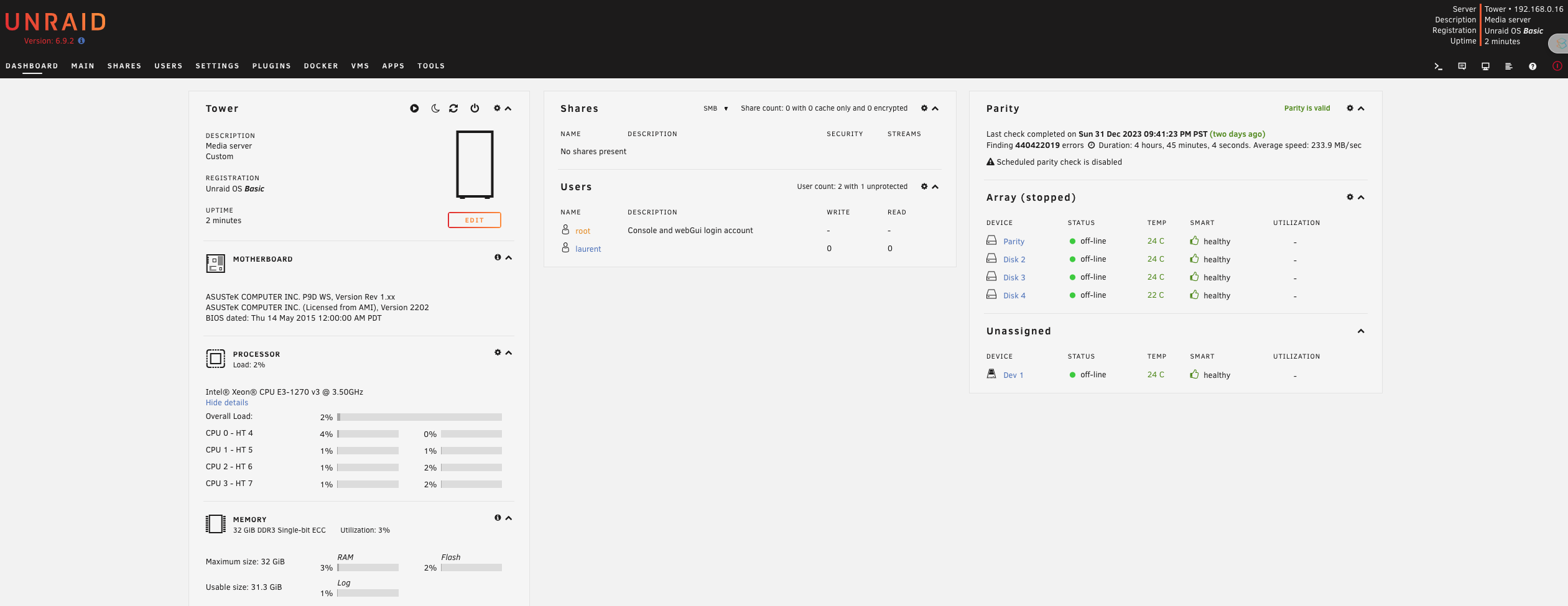

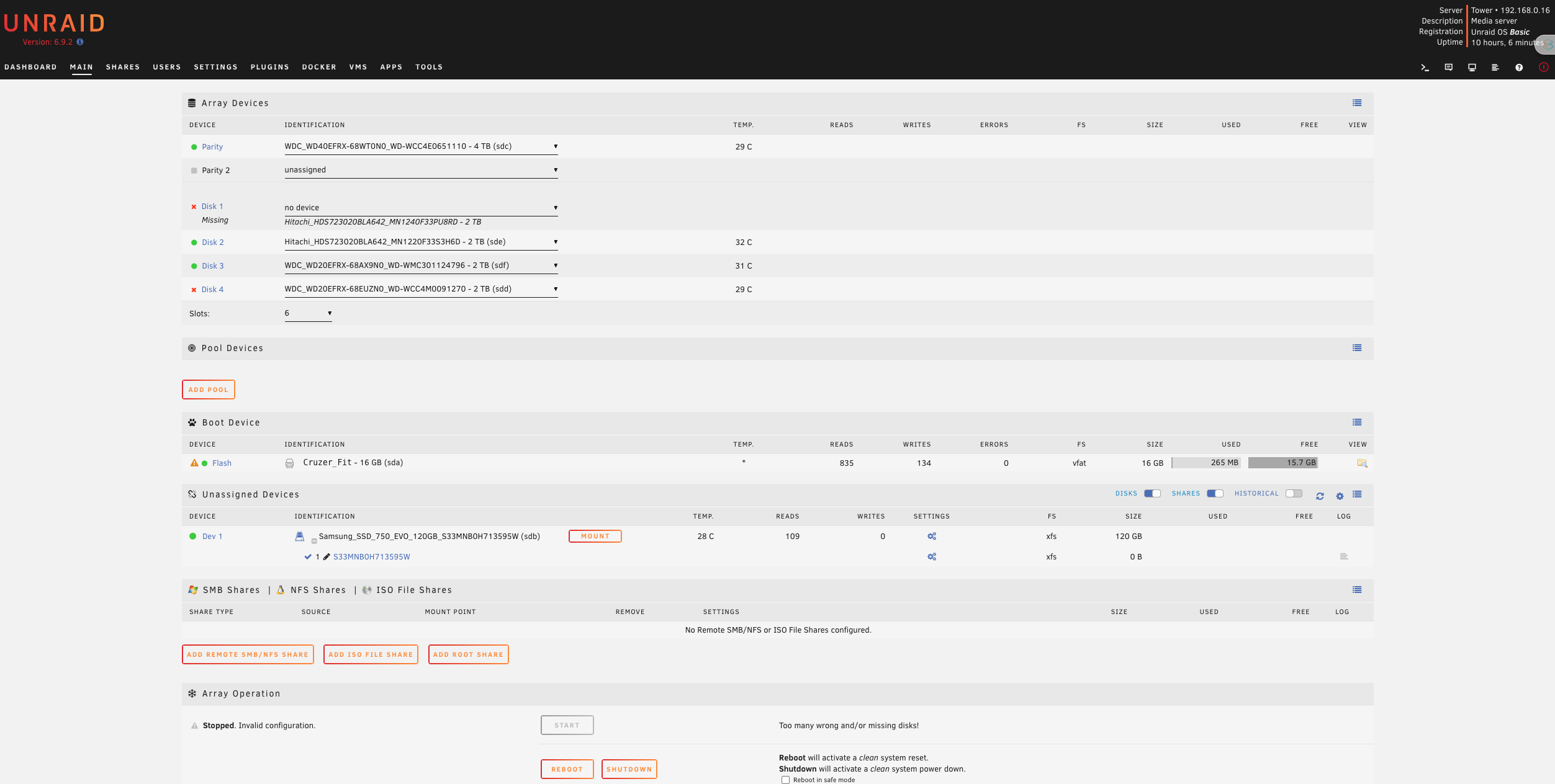

I was wondering whether it is possible (and how?) to recover data and the array after a fatal crash that left me with the parity drive as well as 2 other drives (out of 4). One of the drive is now missing and will remain so as some of the pins for the power are broken. The second drive is there and seems fine with SMART but is not available to the array and is disabled. As such the array is stopped with invalid configuration.
Is there anyway to recover the data on the missing drive and get the array back up again?
Thanks for any help.

The standard recovery methods will not work with 2 drives failed and single parity.
It might be possible to force Unraid to tread disk4 as valid and see if it can then successfully emulate disk1.  @JorgeB is the expert on this type of recovery so I would suggest waiting for him to chime in.
