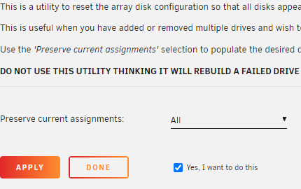

-Tools -> New Config -> Retain current configuration: All -> Apply

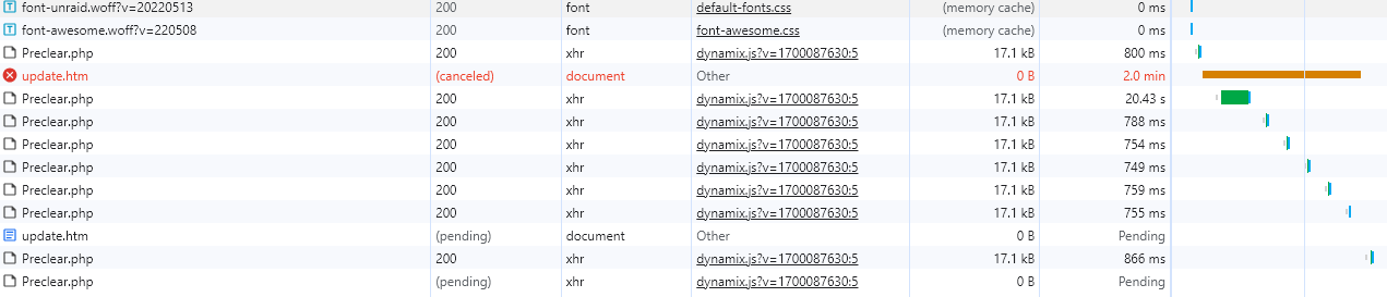

Interesting, when i follow the first step it doesnt seem to respond when i press apply
If i check the inspection tool it shows me this:
When i first pressed apply it gives me the "update.htm" then i waited for 2min, pressed again. Showed me a new update.htm and canceled the first request
Edit:
If i wait it out it gives a 504 after 3min

Try booting in safe mode or using a different browser, don't remember that ever being a problem before.
