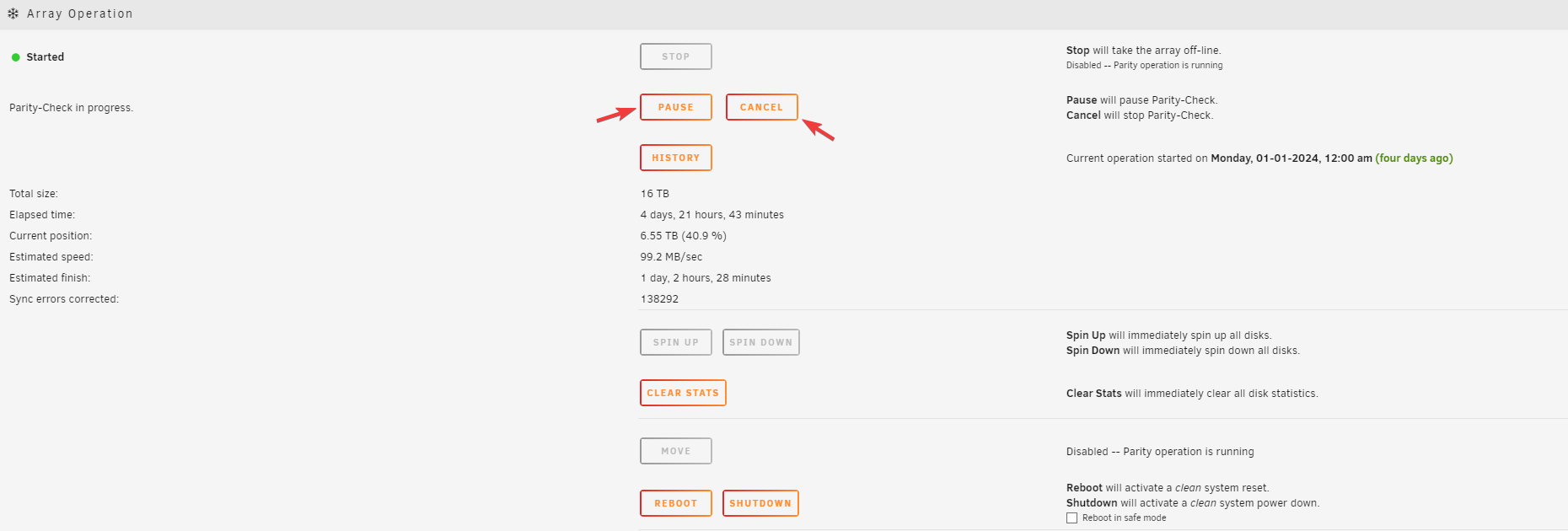

Should a docker constantly restarting stop me from cancelling or pausing the parity check?
When pressing pause or cancel here, it essentially doesn't do anything.
Nope, but it's making it difficult to search the log for other issues.

Hey,
So I've stopped the docker network completely and I now believe there should be nothing major running.
I also tried again to pause or cancel, but nothing happened.
The diags are attached.
Thanks and sorry for the hassle, just trying to do this the right way.
tower-diagnostics-20240108-0346.zip
Still some disk read activity going on, but less then before, if you cannot cancel the check type reboot in the CLI.
