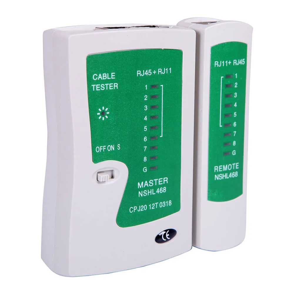

Quickest might be to get a cable tester.  I would think you would only need the cheap sort that are something like £7-£10 from Amazon.   Of course that only works for the cabling - do not think it can detect a bad port on one of the routers.

Okay, thanks:
Then I am going to try that.
Luckily I already had one cable tester underway.
Something like this, right?
Professional-RJ45-Cable-Lan-Tester-Netwo
Yes - that tester works fine for standard LAN cables in my experience.   I used to use one when I was making my own custom LAN cables.
Me too. Just got it out late last year to put plugs on a long piece of cable when I need to go to another room temporarily.
Thanks guys, when it is delivered I am going to test with it.
Hope that I can see quickly which cable it is, because we have a lot of LAN cables here connected...

Though tested the LAN cable with my new apparatus, and the cable was ok.
