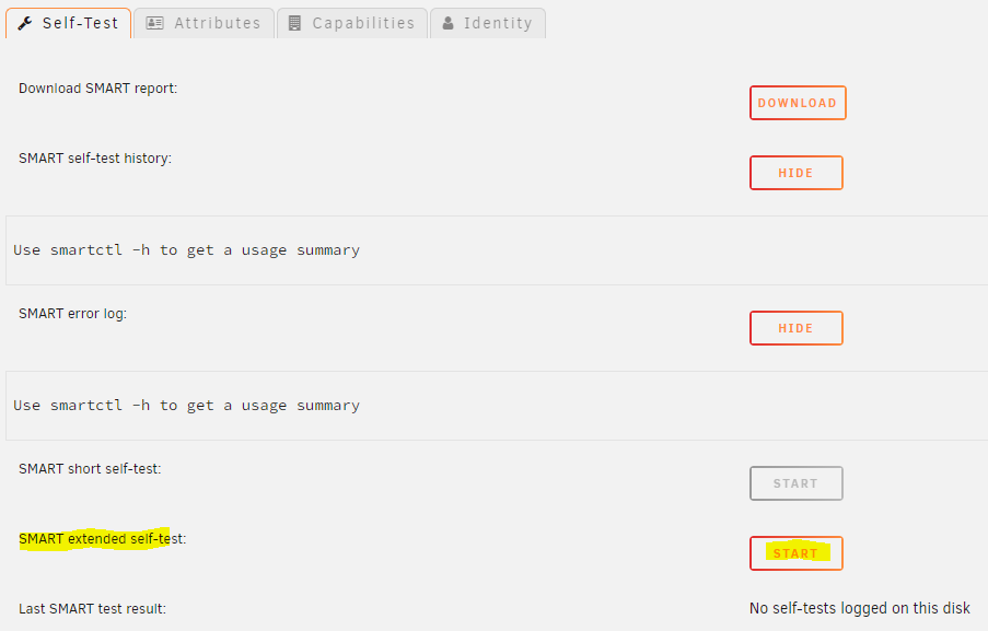

ok, so I've tried to run the extended SMART test, but I'm not sure it's working. When I click on the button, it only takes 2 seconds and then the button goes back as if nothing happened. I can click on it again and again, the result is always the same:

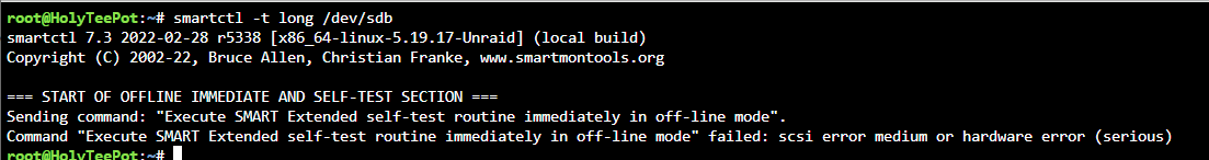

I then tried the smartctl command directly:
Not sure if I did this correctly... but this also doesn't seem to work.
Sorry for being so useless. 😕
Post a new SMART report for the disk
After clicking on the report buttons, it still says "No self-tests logged on the disk".
When I click on the DOWNLOAD REPORT button, I get a 404 error:
Will it do the Short test?
Yesterday it did. (I had uploaded it in my original post.)
Today it doesn't. Not sure why.
