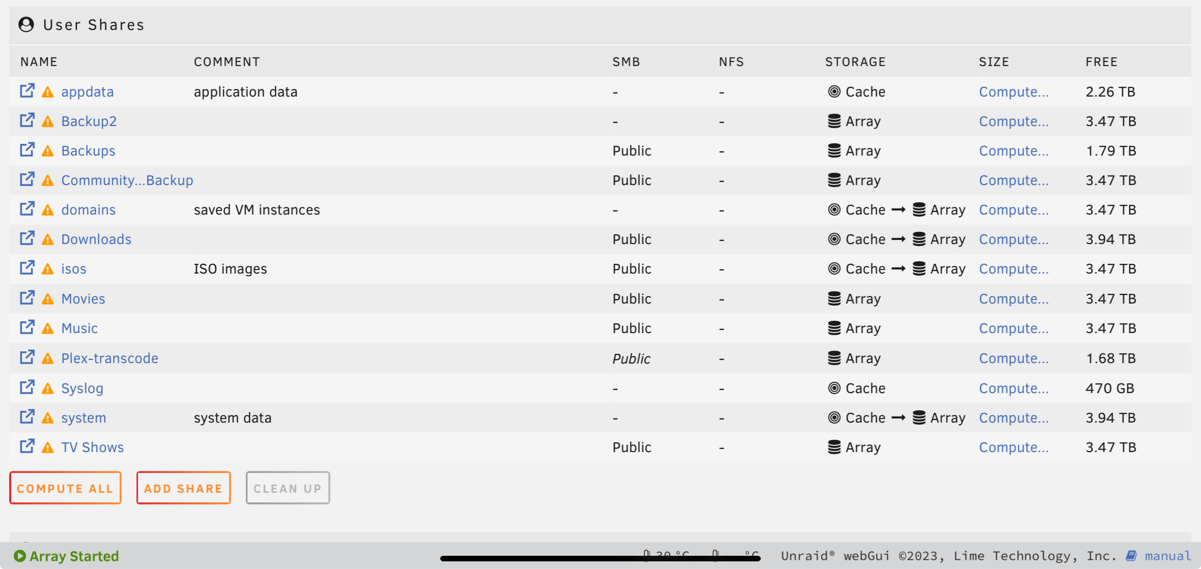

I want to reformat my single nvme cache drive from btrfs to xfs to see if it cures my crashing issues but I’m having trouble moving the contents on to the array. My setup is very basic as it’s only really a Plex server plus pihole and you can see my shares in the image attached.
I’ve changed every share to be on the array only but nothing happens when I manually activate mover. I’m wondering if it’s possible to simply copy and paste the contents of the cache to the array and then back again after the format?

Mover ignores "only" shares. Must be cache:yes (or the equivalent Mover action Cache->Array on 6.12)

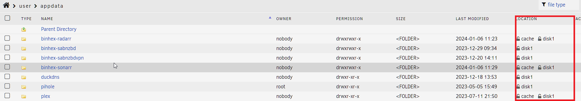

Nope, everything in appdata was on the cache. I've attached an image showing what my appdata looks like after setting it to 'cache -> array' and then running Mover.

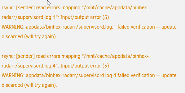

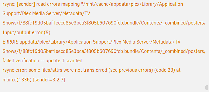

I'll do that now, in the meantime I tried to copy appdata and system folders to one of my array disks using Dynamix File Manager and I got hundreds of errors like the ones shown in the attached screenshots. I dont know if they help identify the problem?

btrfs is detecting data corruption, and it won't let you copy known corrupt files, you can run a scrub to get a list of all corrupt files in the syslog, then those should be delete/restored from a backup, also a good idea to run memtest.

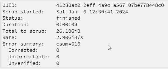

Scrub doesn't seem to report anything.
It found 616 csum errors.
