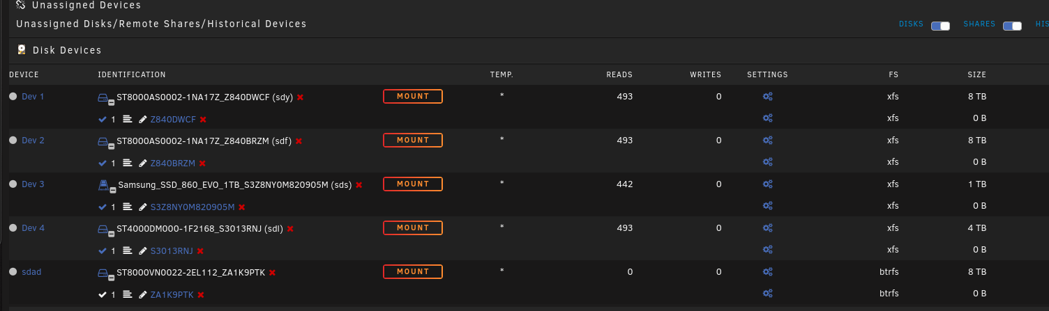

But I just noticed the failed drive, disk 13 with the red X is also showing up under unassigned devices.
Not unusual. The disk disconnects (was sdh) which causes it to become disabled, then reconnects as a different device (now sdad).
You  could try disabling autostart then when you force reboot it should allow you to assign the new disk as disk13. Autostart is in Disk Settings. You can also edit config/disk.cfg on the flash drive to disable it.
