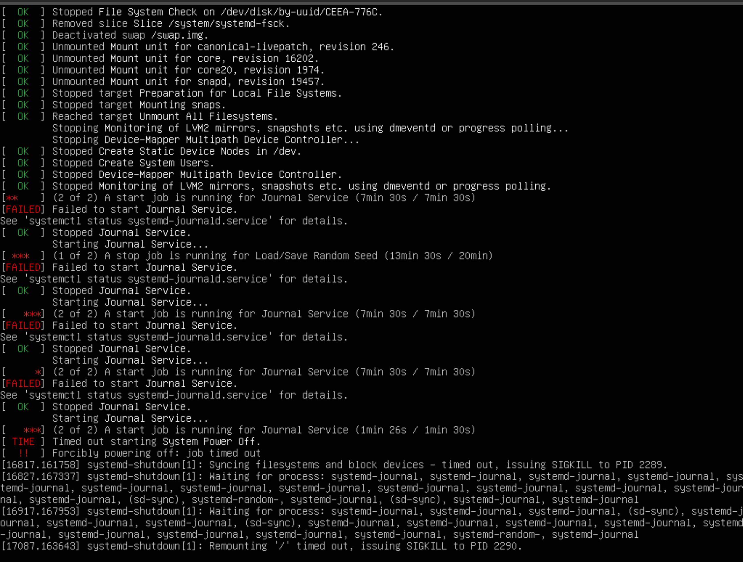

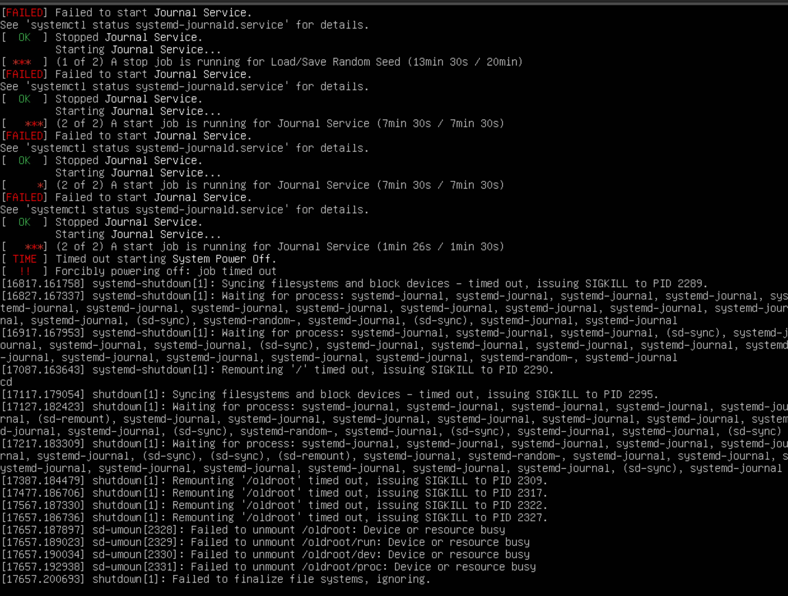

Seems like the whole system is crashing due to this just installed ubuntu vm

In the meanwhile I did start up the syslog server and now i also see some worrying errors even if should not be linked to the vm since these are on different ssd drive (pool) both the domains and isos shares
edit: that was a fresh installed and my first vm span up in the unraid hypervisor, it is a fresh install of ubuntu server 22 lts...
edit2: now I am trying to reboot but is not rebooting even if is stated in the logs that sys is going to reboot, I m quite disappointed of the overall instability.....
edit3: I *guess* it may be due the same vm that does not power off, not even after a virsh destroy, this reminds me of this threadimmagine.png.3c2c1cd988dfd88bacaad4043694f336.png
