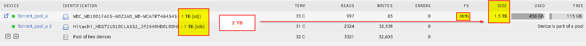

I noticed my BTRFS pool is not 2 TB, but 1.5 TB.

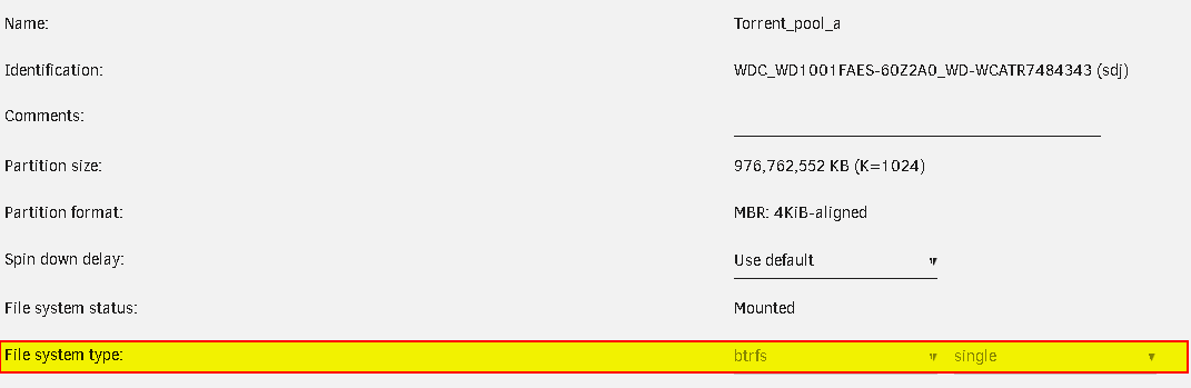

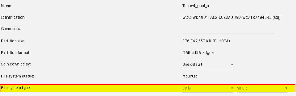

The pool is configured with the File system type = BTRFS; Single:

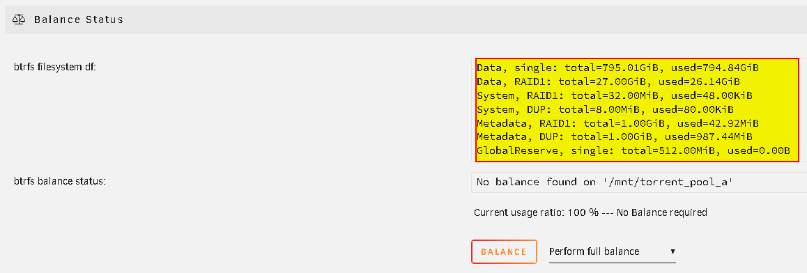

I noticed some unexpected info regarding RAID1:

I originally created the pool as "single", but it looked like unraid created it as a radi1 mirror.  So I cancelled the operation, and have been attempting to redo the configuration without success.

1)  Originally it was 1TB total combine space.  So I attempted to "balance" to a "single" drive, even though I originally selected "single".

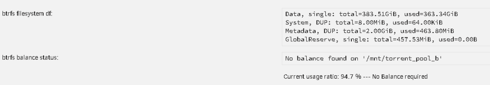

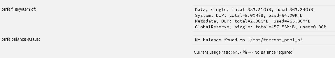

I have another pool created months ago.  I didn't have this problem/steps/scenario.  The "df" looks different too:
I'm getting into the weeds on this.  I'm attempting to run a "balance to single" (I don't know if I need to do a "full balance," or what that will do, but might have to try it), and hope I get back to the point where I have 2 independent BTRFS drives that I can take out of the pool and mount as unassigned (just like the older created pool from months ago). <-- This seems to be an incorrect assumption made by me.  Once the drives are in an Unraid pool, they become part of the filesystem, and no longer separate independent drives.

I expect the combined size of the two disks to be 2 TB.
But from the screenshot, I have 3TB (not 2TB) !
I resolved the incorrect total pool size by restarting the array.
