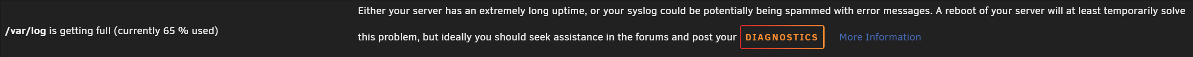

* **/var/log is getting full (currently 96 % used)**
* **Out Of Memory errors detected on your server**

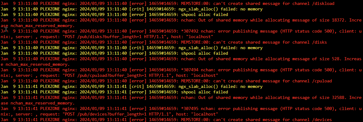

error: Compressing program wrote following message to stderr when compressing log /var/log/nginx/error.log.1:
gzip: stdout: No space left on device
error: failed to compress log /var/log/nginx/error.log.1
and in the logs I see this again:
