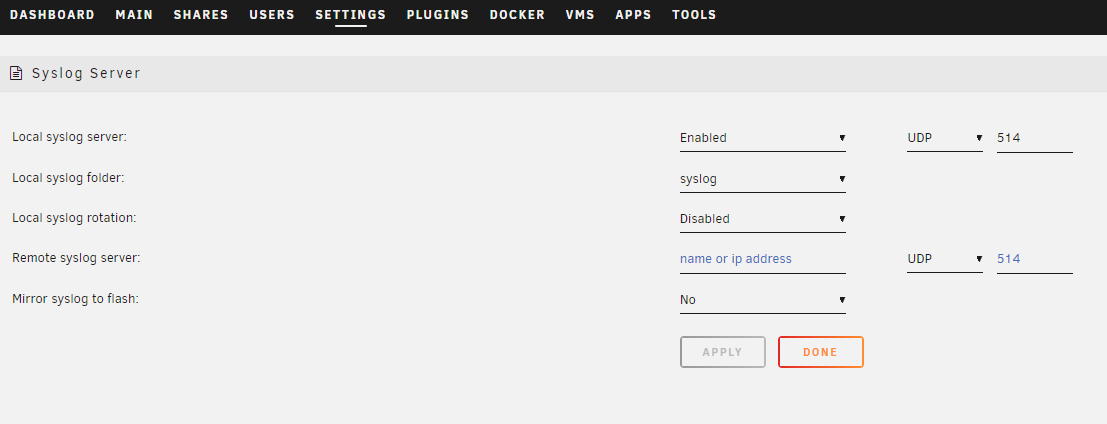

It's enabled. (See screenshot below) but the syslog folder remains empty.

The settings you have mean it is only listening for other servers.   As mentioned in the syslog server link you need to set one of the last two entries to get the server to record its own entries.
The mirror to flash option is the easiest to set up, but if you are worried about excessive wear on the flash drive you can put your server's address into the remote server field.
Ok, got it ! Thank you
