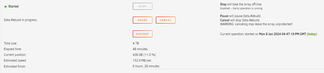

A disk1 dropped offline and came back with disabled disk so followed steps on the forum and powered down server replaced sata cable with a new one, then done steps to clear the disabled error on disk1 but upon bringing array back up and starting the rebuilt process of the disk1 i have noticed the below
1. docker server failed to start and within settings it shows
2. i only have 3 shares where i should have 8 / 9 shares, the 3 shares present appear to have nothing in them and viewing shares over a network they appear empty
but checking array it shown the data still present
I have a rebuild for disk 1 is in process so cannot reboot at this moment and time this might fix it but opened this help request in case it doesn't and looking for input

A reboot should bring the shares back.
So the array finished its parity check and after reboot all came back, this is the first i seen this before is it a bug with the 6.12.2 ?
Not sure it's a bug, but it was not finding the correct mount paths.
