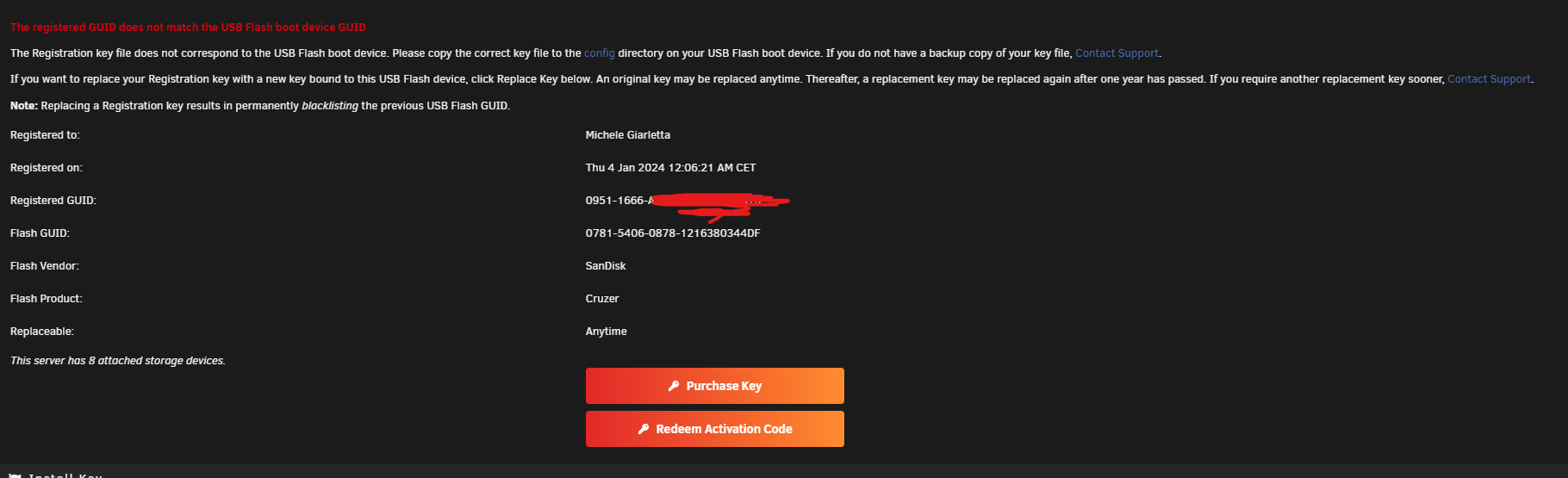

now i followed the instructions, at first I did wrong since I left the Trial, Plus and Basic and unraid was complaining that keys from a different guid were in the config folder

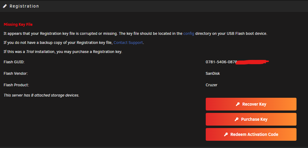

now I do not have at all this Replace Key button ( https://docs.unraid.net/unraid-os/manual/changing-the-flash-device/ )
indeed thats all i have (see pic)
trying to recover it wont work neither Error: {"message":"Request failed with status code 403","data":{"error":"GUID '0781-5406-0878-*************' not found. Please contact support for assistance."}}
How can i finally change this drive? Thanks all

I did at first but unraid was complaining that the key file was wrong and there was a mismatch, also no replace button appeared
i did place the keys back in the config folders and here it is the same error as before
There should be only 1 key file (presumably the Plus key as the last one that was valid).
I cant believe this was the problem, thanks (yet i believe this should be stated somewhere in the docs or should be coded better into unraid being a bit more user proof)
