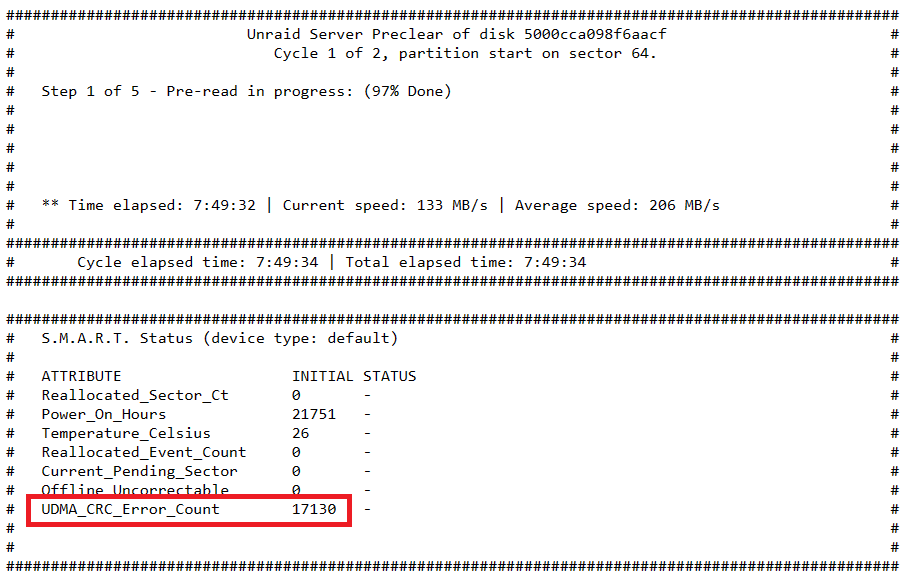

I just checked again and its still progressing, although has slowed quite a lot from the early speeds... one thing I have noticed, which was the same on the first check above but I didnt spot, or include it in the screen shot... the CRC Error Count is listed as 17130... I am not entirely sure what this means, but am guessing 17130 errors is not a good thing? Although my understanding is that this was probably caused by a connection error in the last owners machine. I think I'm right in saying that as long as this doesnt increase in my installation it will mean everything is good?
Edited by SliMat
Longer outer tracks have more data than shorter inner tracks for the same RPM, and it starts with the outer, so normal for the data rate to decrease somewhat as it progresses.
Probably explains the slow performance they were getting.
Yes (as this count never resets).

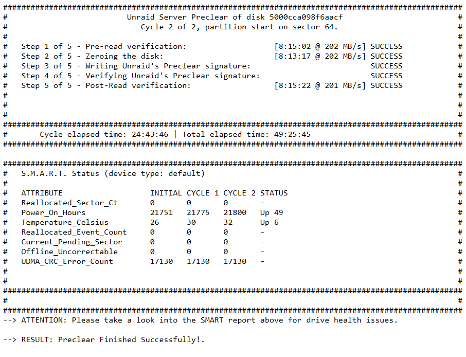

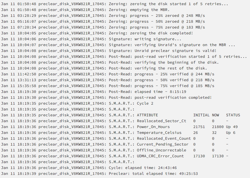

So, preclear has finished - do you think this is enough to prove that this dosk is OK to add into my array? I've pasted the results below and as far as I can tell it all looks good and I think the problem the last owner suffered was because of a cable/controller problem rather than a disk problem...
The top line (sdh) relates to the 6Tb drive
Edited by SliMat

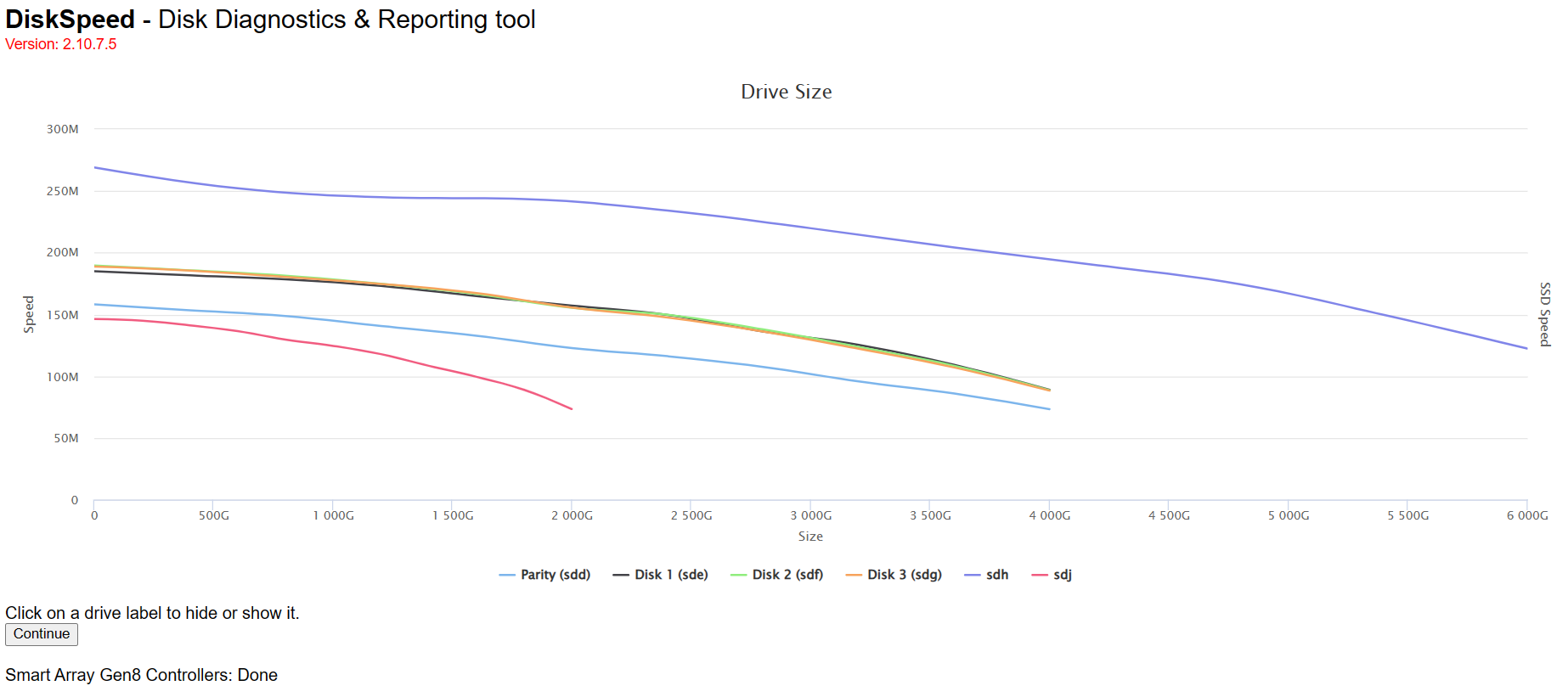

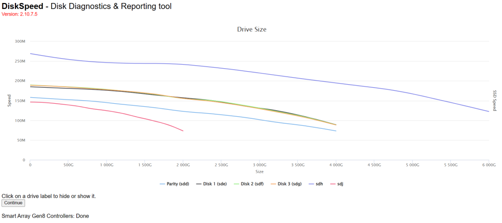

Good advice... and I do the same. The server I want to add this to has 6 x 6Tb Purple disks and has been running for 2 months now... one observation from the DiskSpeed screen above... I noticed on the server with 6 x 6Tb disks the speed trace of all the disks is identical... which is reassuring... however the screen shot above is from a server at home which has 4 identical 4Tb RED disks plus a few unassigned devices, such as the 6Tb disk I am testing.
However on the trace above, the 3 x 4Tb RED disks in the array have identical traces, BUT the exact same 4Tb RED disk which is assigned parity disk is the blue line immediately below the trace for the 3 array disks. Is it normal for the parity drive to DiskSpeed slower, or should I be concerned about imminent failure?
I've never used the DiskSpeed docker until your recommendation above... so am not sure what to expect.
