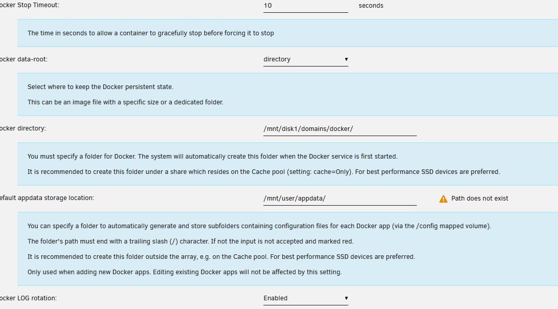

Doesn't look like you have a valid path for docker.img.
Post a screenshot of Docker Settings.
what would be a valid path?
It has to be a filename.    The normal default is /mnt/user/system/docket.img.   Any reason for changing it?

Is that the complete screenshot of Docker Settings? I think there may be something different about some of the rest of it based on the blue help text.
OK, I see now in your docker.cfg you have specified to use a folder instead of a docker.img.
I've never done it that way and have never seen a need for that. I think it is just a lazy way to let docker space grow uncontrollably.

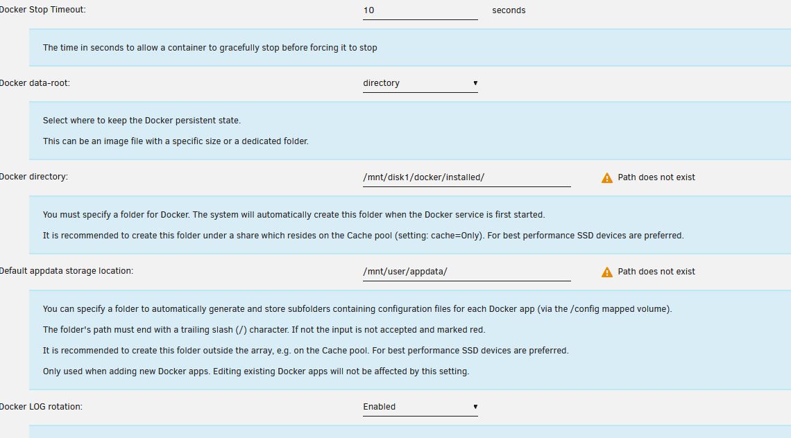

i stopped the array and put reset in docker settings....then apply. Now it looks loke this..
What happens if you try to enable Docker?

Just realised you have set docker to use a directory rather than an image file.    I would suggest /mnt/user/system/docker.    If you use a file instead then the default name of the file is docker.img.   It is normally under the ‘system’ share - not sure why it is in the ‘domains’ share for you!
I enabled docker and now it seems like i can install again...i will try

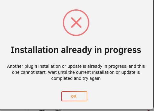

The templates that have the settings you use are stored on the flash drive and you can re-install docker binaries using previous settings via Apps->Previous Apps->Docker.   You want to install the Appdata Backup plugin that can automate making a backup of the working set files for each container (normally held in the appdata share).  That plugin can also make a backup of the flash drive if you want.
at the moment I cannot install appdatabackup....I will try lUnbenannt.JPG.3c55b776f5065d1f065a44f4daa7ca1a.JPGater again.
