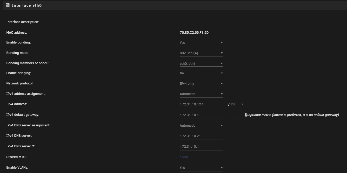

Did you make sure to disable bridging on eth0 as mentioned in the Release Notes?   Normally required for the system to be stable when using macvlan.
Definitely it's disabled with only bonding enabled.
I tried to revert all of my changes, going back to ipvlan, with bridging and bonding enabled like it was for like couple of months but I think that if it's not working with Docker service disabled it's not a root cause. I also tried to disable bonding at all with only bridging enabled - still same problem.
