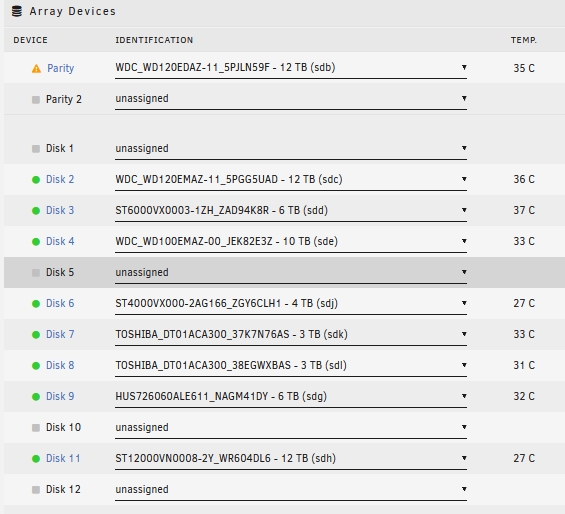

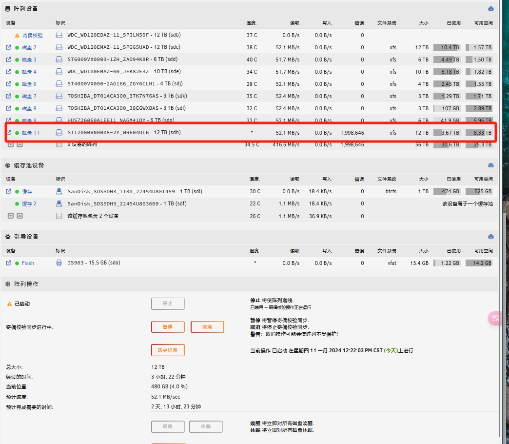

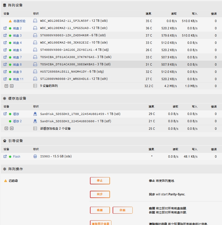

Disks 9 and 11 are in an external disk cabinet. Even when I use a 'new configuration', these two disks randomly drop out during the synchronization process, their temperature cannot be measured, and read errors continue to accumulate.
After the error occurs, I stop the array and then reboot. The faulty disks can automatically mount and the array starts, everything appears normal. The disks have been checked and no issues were found.
I attempted to start the array and automatically sync three times. Each time, these two disks had issues, whereas the other disks not in the external disk cabinet did not encounter any problems.
My server is a Gen8 ml310e v2, with a P222 serving as the HBA card connecting the internal hard drives and the external disk cabinet.

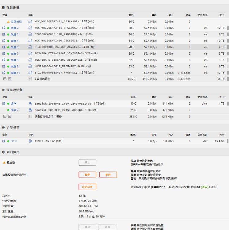

After the error, the read error count keeps accumulating, and many of my services become inaccessible. Therefore, I clicked 'Cancel' to stop the verification and restarted the array after rebooting, which restored normal operation of services like Docker.
During a previous attempt, I also tried to directly stop the array, but the UI froze, and I ultimately had to resort to a hard power reset.

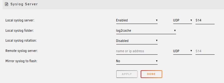

I setup local syslog server to "Enable",Is it possible to view the logs from the past few days after a reboot? If so, I will reboot the server now.

syslog is in RAM just like the rest of the OS. Unless you have syslog server setup to store it somewhere it is gone.

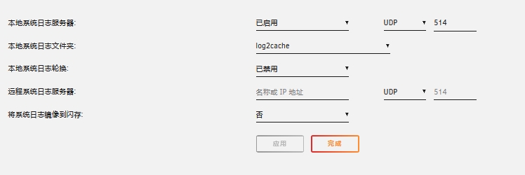

Better post a screenshot of your syslog server setup, it can be confusing.
Screenshot as follows.
I have about 500GB of space left in my cache. Will doing this cause the cache to fill up and lead to Docker running abnormally?
if the settings are correct? If so, I will start the disk verification again and promptly download the diagnostic logs if there is an error.

Can't read that. Are you logging to flash drive? Or what do you have set as the remote server?
And diagnostics will not include the syslog from syslog server you have to get that from where it is stored and post it.
Sorry, I have taken the screenshot again. I have set the logs to output to my cache disk. Please check if this setup is correct.
Should I directly reboot next, or start a new verification and wait for the error to occur?

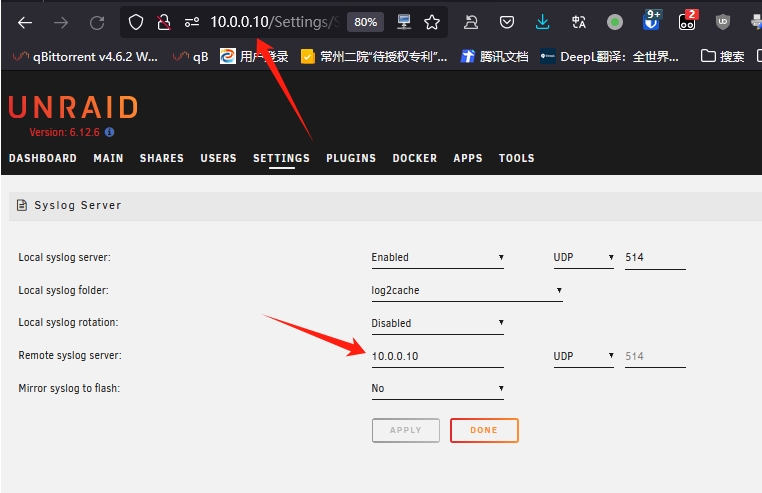

You have to tell it what remote server to log to. Put the IP address of your server to get it to send the log to itself.
Is that so? Then, should I reboot the server and wait for downloadable content to appear in the folder?
wait for the error to occur then get it, zip it, and post it.
OK, I will start a new verification and update this topic when the error occurs. Thank you

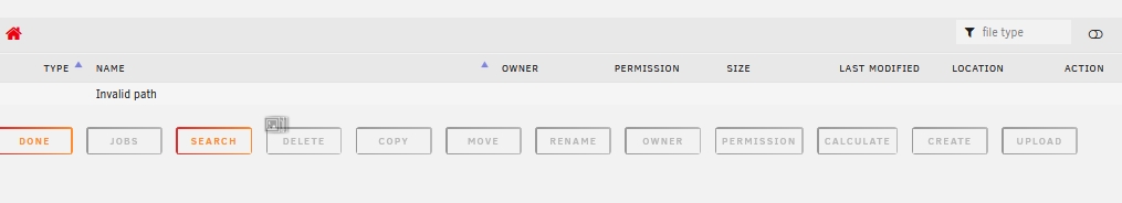

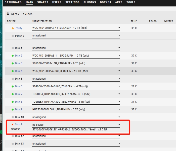

Now I have paused the validation.Click the arrow in front of the disk to view its contents; it shows 'Invalid Path'.
Strangely, it appears to be readable on the UI. After stopping the array, the disk shows as missing.

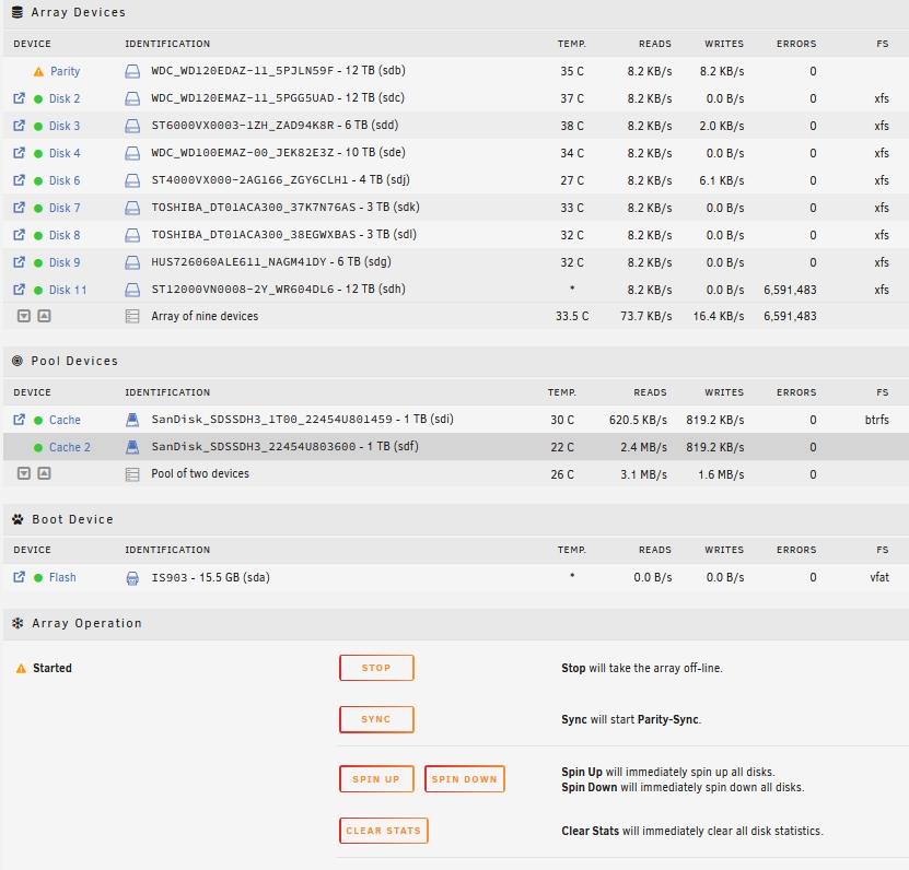

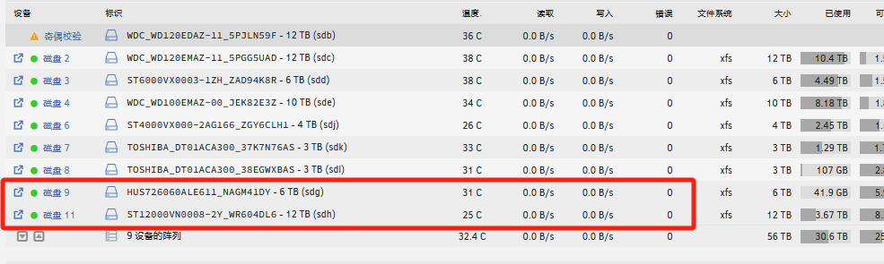

Either the 9th or the 11th disk always have read error on one of them. In 5 verification attempts, they have never both experienced read errors at the same time.
Once rebooted, the disk list appears to be normal, but I have to manually stop the verification to prevent the 9th and 11th disks from experiencing read errors again.
Diagnostic logs and syslog have been uploaded above for your review. Thank you.
