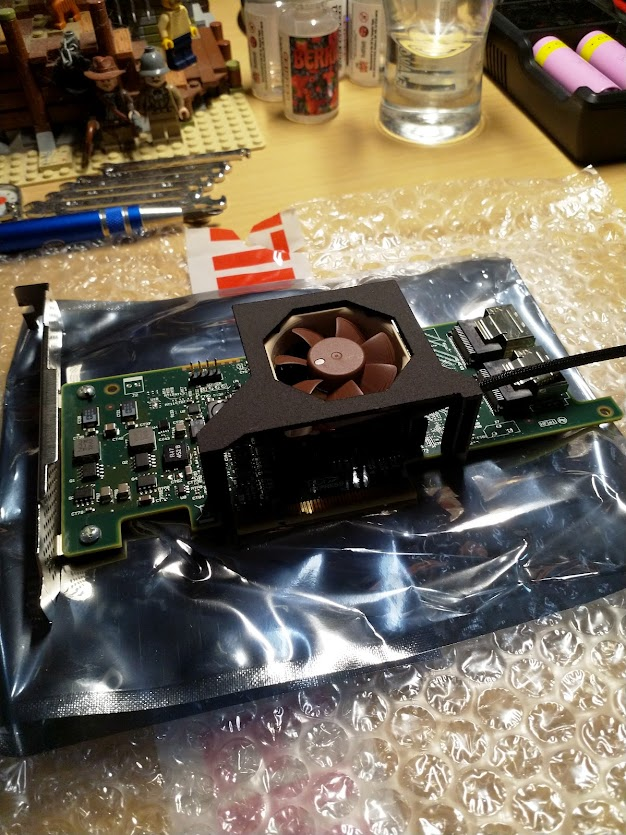

Don't have a fan on it. In the server are 2 noctua 120mm in the front and 2 80mm in the back

Nothing relevant logged, can you still use the server without the LSI? To confirm if that's the issue or not.
This controller is server-hardware and has a powerconsumtion of 9,8W - 16W (!).
Without cooling, it gets "very" hot - this is (maybe) the reason for you crashes...
Operating Temp: 55° (max.)
It needs an active cooling with 200 lfm (1m/s) or 30m³/hour.
