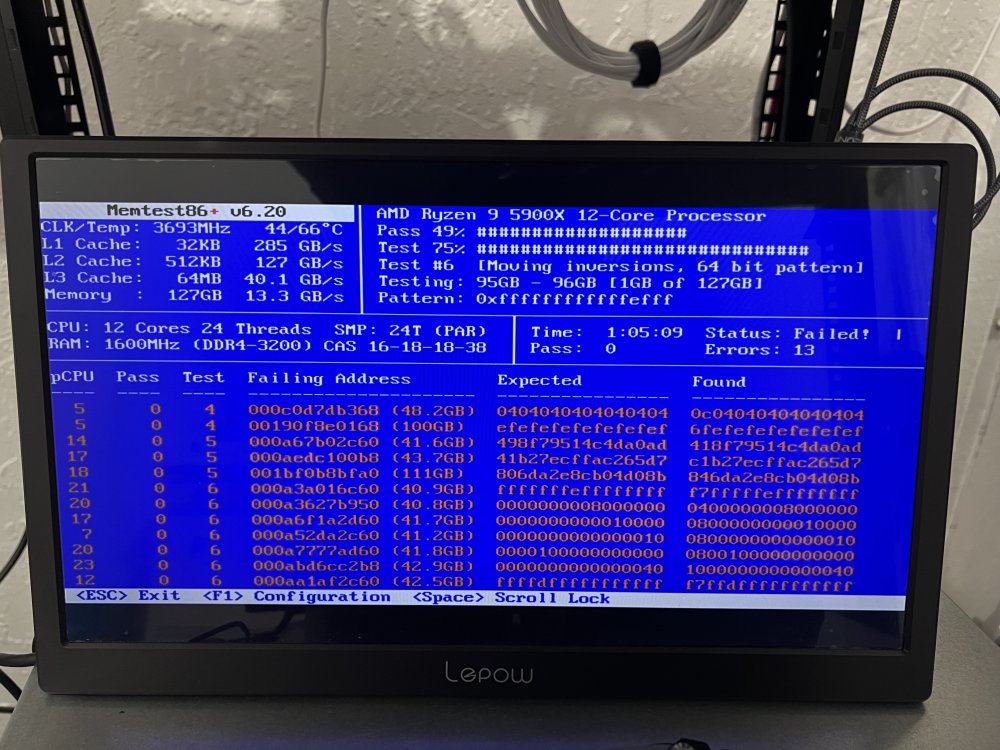

I was not able to get memtest running from  USB. I downloaded it, used their flashing program and followed the instructions. However, it did not work, nothing would happen when I tried to boot from the USB.
However, Unraid has memtest built in, so I used that.
I assume my memory is dead? I was told to reseat the sticks and try again. I am going to do that.
This is what I got at almost 50% done.
The moment you get even a single error in memtest you have a RAM problem ☹️
Unfortunately the opposite is not always true - sometimes memtest shows no error but you can still get RAM errors when the system is under heavy load.   That is one of the reasons we often suggest to try with less Ram sticks installed
Understood. I am going to try tested each stick 1 by 1 and see what comes out of it. I guess this is the reason for all my crashes :(
So now that I know I have a bad stick, I tested each of the 4 sticks alone, and found the bad seed. I can change that and I should not have any more weekly crashes?
If that was the only issue it should be solved, retest.
