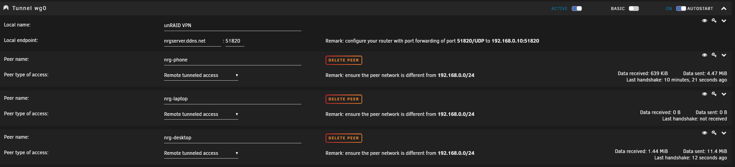

Wireguard on my Unraid server has always worked quite well, but today I noticed that when I connect to my server through the Wireguard client, I can access my server directly via IP address but I can't access any websites outside my local network. I haven't changed any settings on my Unraid server. It seems like a DNS issue and I've already tried switching my DNS servers in the Unraid client to try 1.1.1.1 and 9.9.9.9. Hoping someone here can help me debug this issue.

As you can see in this picture from the integrated help, you should access server, the network and aswell the internet. I just started with unraid, but @nrgbistro seems to had a working configuration, until it stopped. I dont know, maybe you did a update from unraid in the past?
