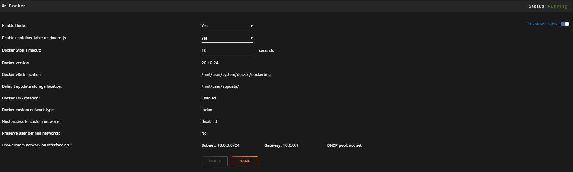

Already do it.. it's verry strange, in the webGUI i'm in IPvLAN...

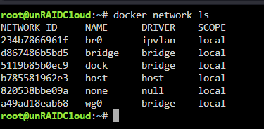

hmm, not according to diags, post the output of:
docker network ls
docker network ls
here u are the result of the command :(

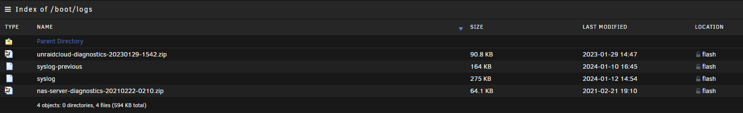

Diags you posted are from Jan 2023, wrong ones?
It's the recently log i have, but i can download it again and send again if u want
syslog syslog-previous
You can generate new ones.
OK, that shows docker using ipvlan, do you remember when you changed that, and did you reboot after changing it?
The macvlan call trace on Jan 6 suggests it was still using macvlan at the time, and it can crash only later, even if already changed to ipvlan, if the server was not rebooted after the change.

I put IPvLAN on December 27, 2023 and rebooted the machine, I'm going to do a clean reboot just in case... that's why I'm completely lost... I was thinking of a script so I deleted tailscale and fixed common problem that I was using but nothing works, the same, I deleted some docker just in case but I have the same problem..
