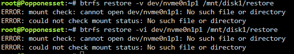

I tried the first two recovery options, here are my results...nothing great it seems.image.png.e64a4aefb18cf29ea7a7dcc4b2f50e41.pngimage.thumb.png.0f29f85e0c5d46b02649752aee203ac5.png
On the first to command you are missing the first forward slash, it's /dev/nvme0n1p1

Got it. Ok. I have a restore folder full of what seems like everyhting off of my cache! which i hope is good news!((thank you so much for the help thus far!).  What should I do next? I attached diagnostics...just in case
