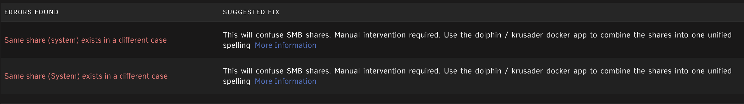

Confuse SMB shares (system)
FixProblems discovered a problem with my System share734158750_Capturedecranle2024-01-13a17_16_44.thumb.png.a4ddf59bf49adb9f28e2a9cf6c4d97bf.png
this share only contains my docker.img
I copied the docker.img to the directory /mnt/cache/system/ and erase the /mnt/cache/System/ folder.
After restarting the Array, the docker vDisk location is in /mnt/cache/system/docker.img,

How can I fix this ?

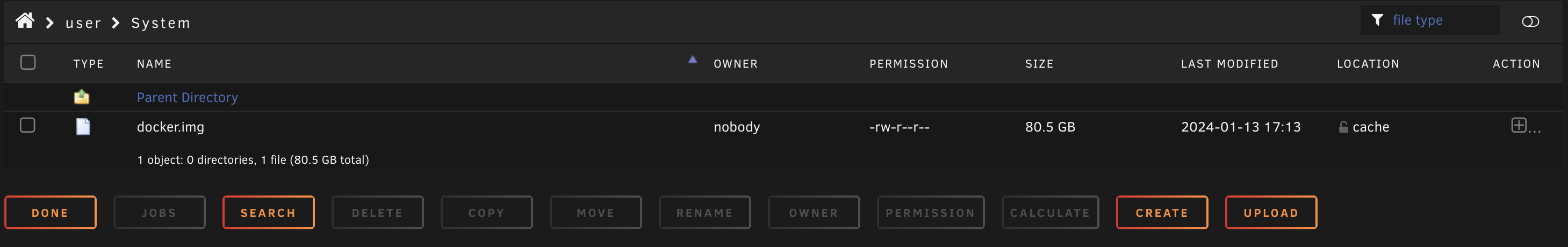

1391317085_Capturedecranle2024-01-28a13_10_53.thumb.png.d5ee15ee101d6a3adbc7009af5b4230b.png
How can I be sure to delete the correct one? system or System ?
You want to delete System, not system. Unraid is not confused. It is showing you the correct names. Your screenshot is showing the contents of System, the file you want to delete.
If you notice, the dates on the 2 different docker.img in the 2 different shares (system and System) are different. The System share is older and not being used.
Also, it won't let you delete the file in system because it is being used.
