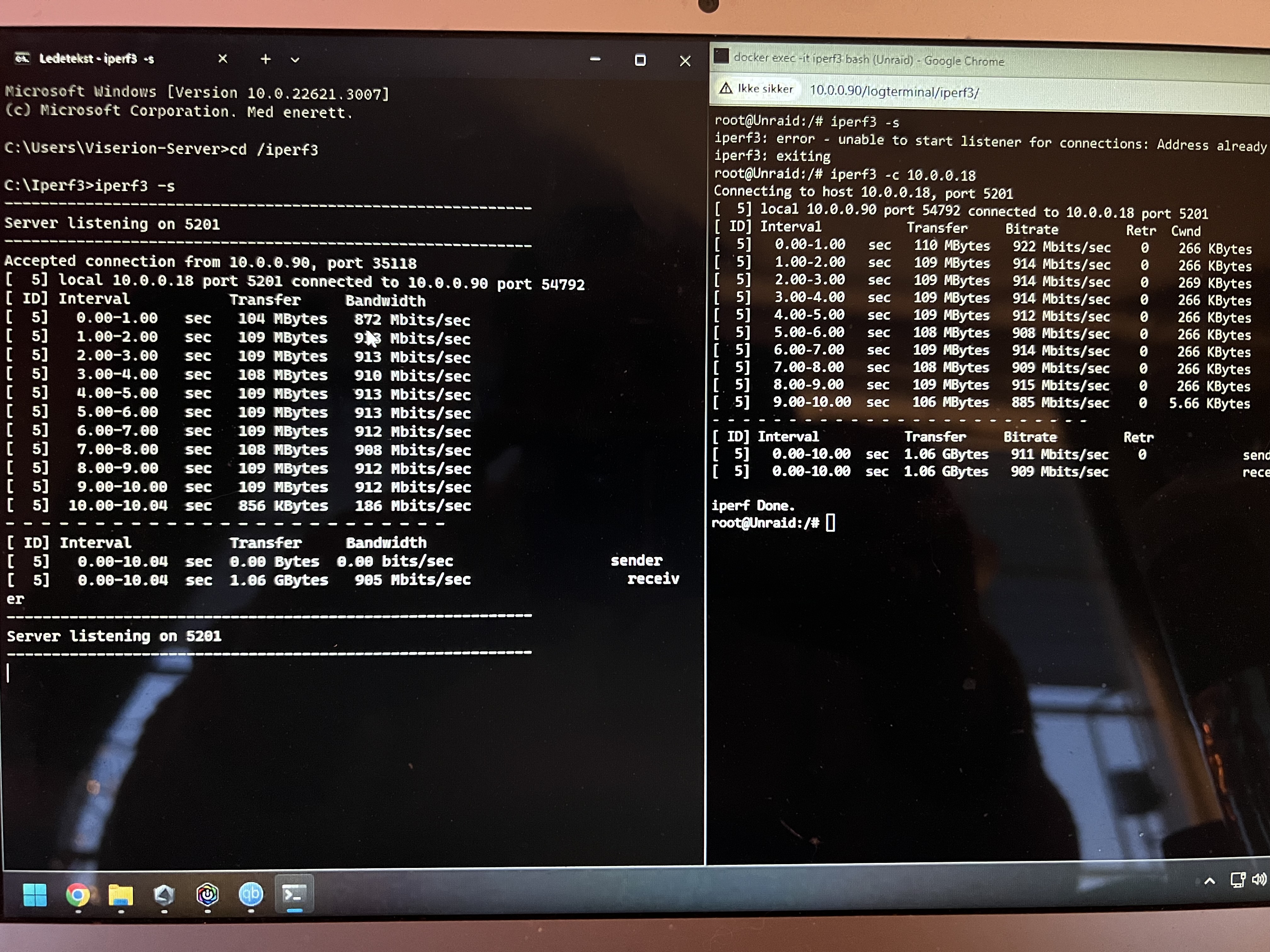

6 minutes ago, JorgeB said:
like this?  Unraid server is on the right..IMG_5318.thumb.jpeg.cab7fc1ee78d8e70b7cba2f993d29e84.jpeg
OK, that looks good, now post a screenshot form Windows explorer, with the speed graph on, showing a large file transfer, first to the array and then the same transfer to cache.
