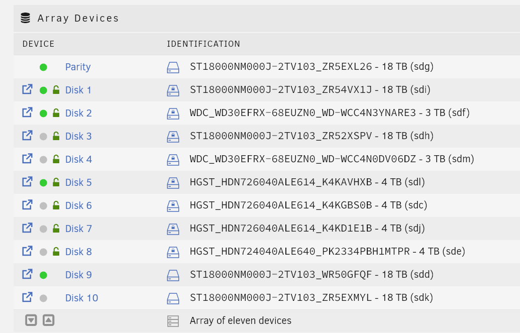

PS: Is there an easy way to go from xfs to xfs encrypted? 2 out of my 12 HDDs are not encrypted... because of that bug. (without deleting data or moving data)
No.  Changing the file system type always involves copying the data elsewhere, reformatting the drive and then copying the data back.

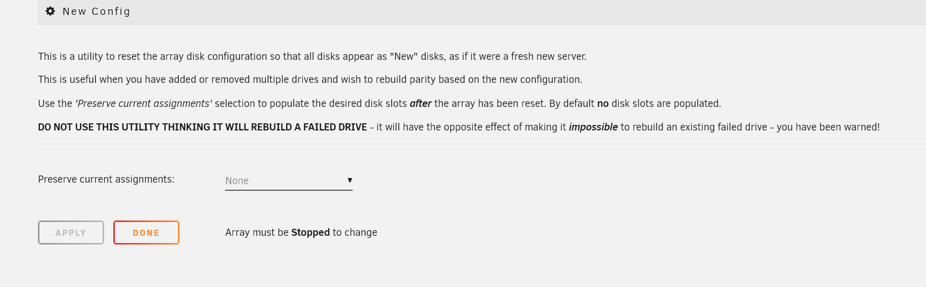

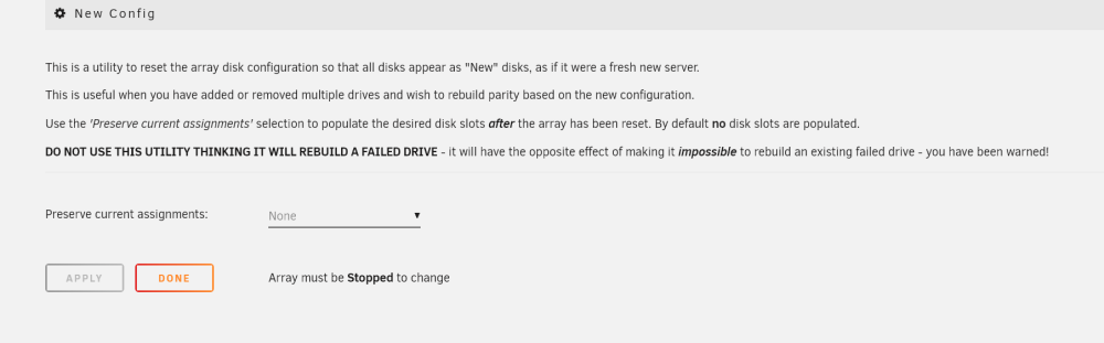

If its by design, it should be changed. Why should it clean the settings there? that doesnt make sense? Its clearly sayin
This is a utility to reset the array disk configuration so that all disks appear as "New" disks, as if it were a fresh new server.
1.) remove that bug
OR
2.) add to the text that you also default (remove) your settings/disksettings
1.) remove that bug
OR
I wonder what else is affected...?
I interpret that phase as meaning that any settings that refer to drives in any way get reset to their defaults.

It's there. "reset the array drive configuration [...] as if it was a fresh server". So every setting relating to array drives is expected to be forgotten.
Array drive configuration = where the disks are 1,2,3,4,5,6,7 and so on.
THIS!?
