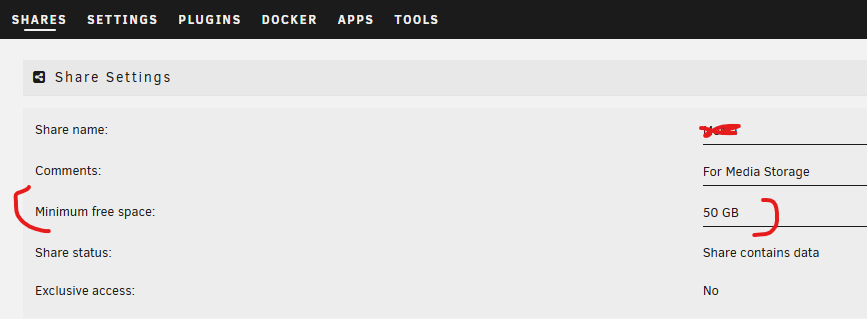

Second thing, you have not set up this parameter on the shares that I checked:
It should be about double the size of the largest file you will ever store on this share.  Unraid checks before it starts a transfer that this much free space is available on the disk where it proposes to write the file.  If that amount of space is not available, it will move on to the next disk allocated to this share and write the file on that disk.  Once Unraid starts the write if there is not enough space on selected disk, the write will simply fail.
