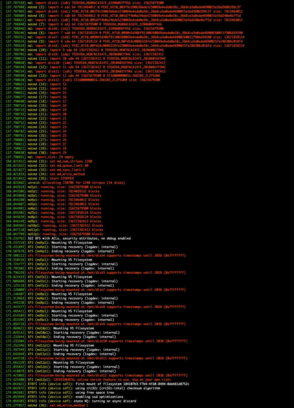

soooo i got into the situation now ... that i have replaced the controller.
But i cannot get them to mount into unraid as part of the Array.
However i can mount separately individually without any issue... Any recommendations ?

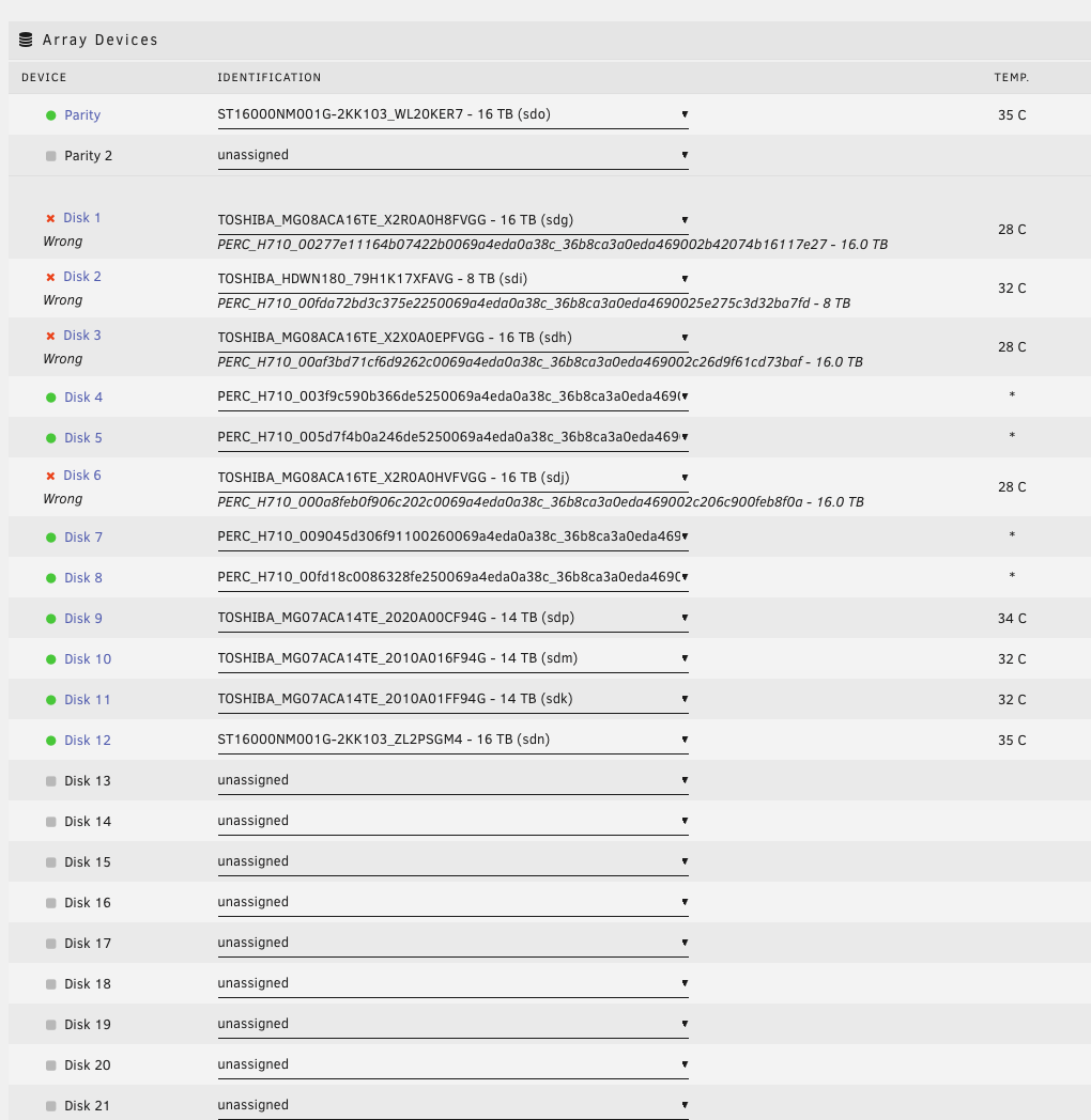

Below my old config with the perc710 controller (now i am using a 24i - 9306 or so LSI based controller )
435362712_Screenshot2024-04-02at22_34_53.thumb.png.14d1ffd2b6c7b5fa0baff5a57ba8d05e.png

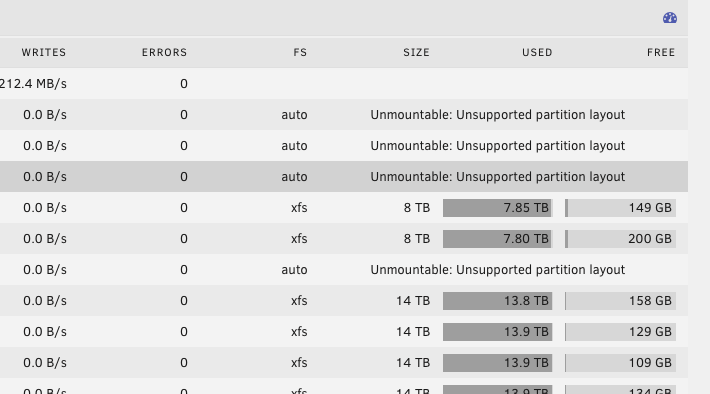

Unfortunately now however - although the partitions look almost the same, it is saying "unknown partition layout" cannot mount.
However on the command line i can mount them individually - so all my data is there.
Now i would love to know what partition information / schema Unraid exactly is looking for - so i can change the disks partition layout.
I mean start sectors are quite the same - just at the end seems there is a 512MB patch free that the other native unraid formatted disks dont have.
All disks have UUID and actually show XFS as well here.
Any ideas anyone ?
I mean i have all my data still there ... ?

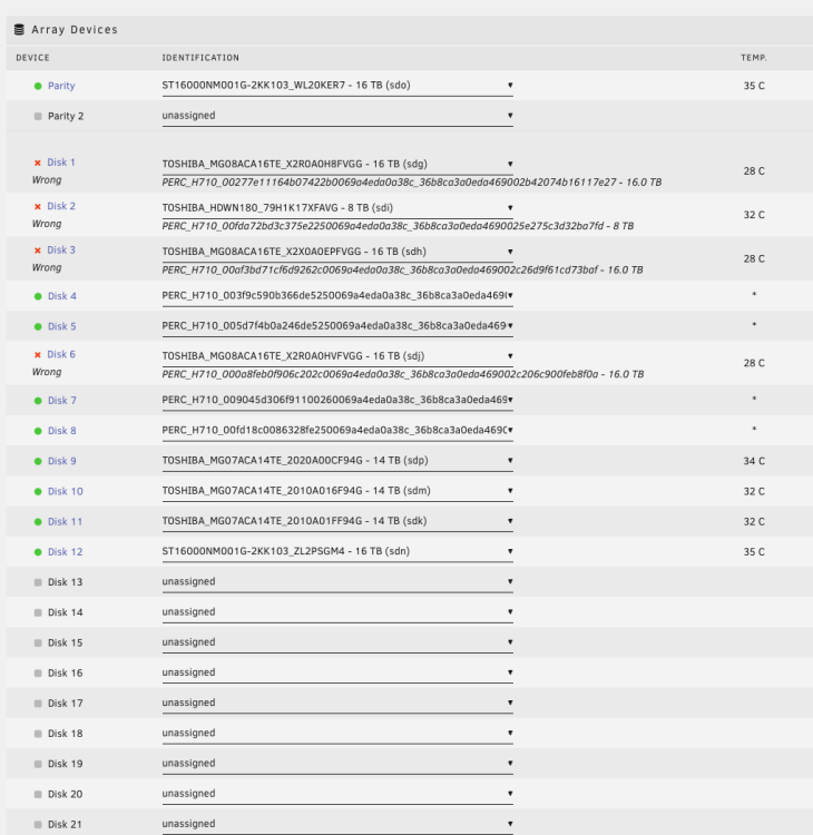

1049562392_Screenshot2024-04-02at23_34_07.thumb.png.b6962e1d1bc619fae2f98fc12a7508d6.png
Needless to say in the above screenshot you can still see 4 more drives having the DELL naming ... those are coming as well over ( still on the old controller ) .

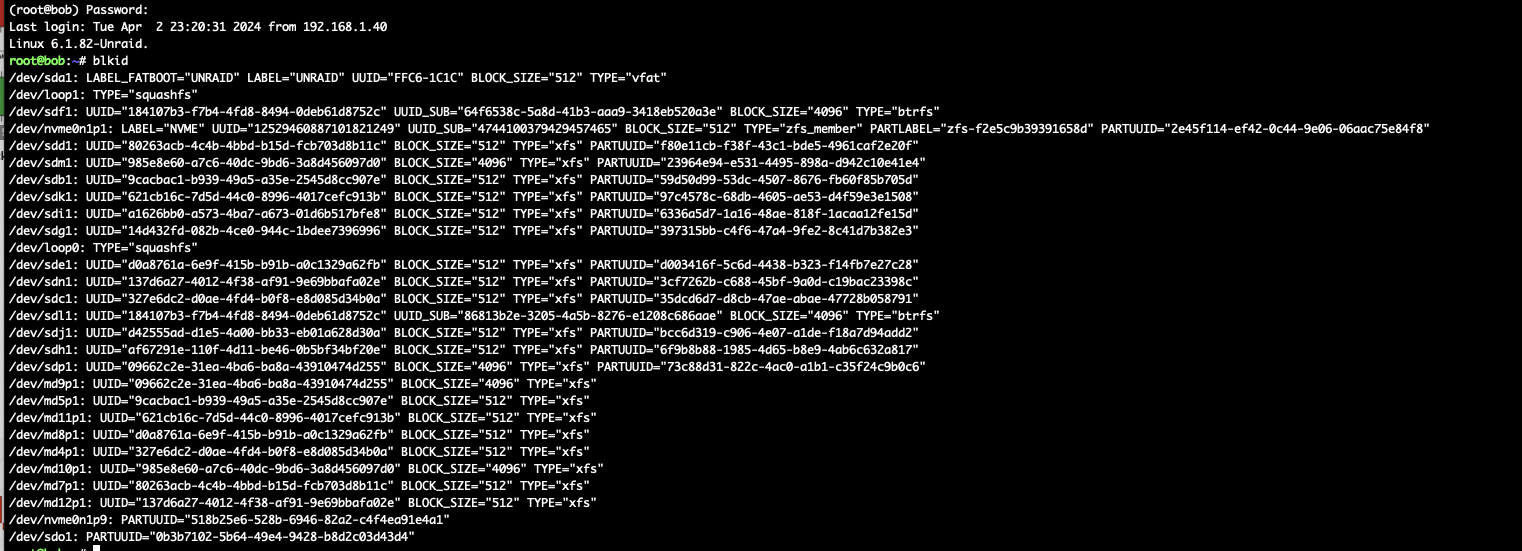

If i mount i.e. my disk1 ( sdg1 ) to /mnt/disks1/disk1 manually :
The mount message is the same ( again rightfully seeing V5 Xfs etc ) ...
This is what i see for those disks...

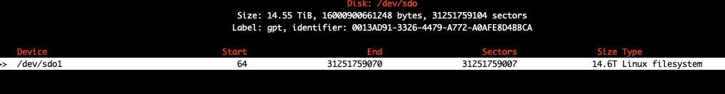

The parity drive (which works) with fdisk -l /dev/sdo
root@bob:~# fdisk -l /dev/sdo
Disk /dev/sdo: 14.55 TiB, 16000900661248 bytes, 31251759104 sectors
Disk model: ST16000NM001G-2K
Units: sectors of 1 * 512 = 512 bytes
Sector size (logical/physical): 512 bytes / 4096 bytes
I/O size (minimum/optimal): 4096 bytes / 4096 bytes
Disklabel type: gpt
Disk identifier: 0013AD91-3326-4479-A772-A0AFE8D4BBCA
Device     Start         End     Sectors  Size Type
/dev/sdo1     64 31251759070 31251759007 14.6T Linux filesystem
1726399123_Screenshot2024-04-03at00_25_41.thumb.png.b6ea0df21bd539e10dfc0bfa820f8ffc.png

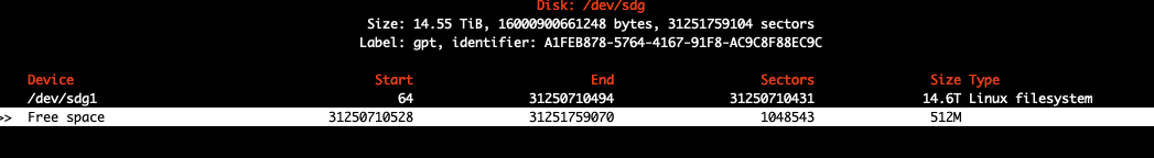

and a similar size but not working :
root@bob:~# fdisk -l /dev/sdg
Disk /dev/sdg: 14.55 TiB, 16000900661248 bytes, 31251759104 sectors
Disk model: TOSHIBA MG08ACA1
Disklabel type: gpt
Disk identifier: A1FEB878-5764-4167-91F8-AC9C8F88EC9C
/dev/sdg1     64 31250710494 31250710431 14.6T Linux filesystem
cfdisk is showing the 512M at the end of the disk
463002766_Screenshot2024-04-03at00_25_28.thumb.png.6252cc4a226ca21d17883b68bfaadf62.png

Ok i have thank you - with your help its figured out now.
Now for everyone who faced the same issue - just to document it : With Perc 710 controllers - whereas the single disk was configured as a virtual disk you need to do the following, assuming you have to change more than 1 disk in a row - because i.e. like in my case with a poweredge T620 the drive cage is 2 x 4 drives connected via a 4i cable each so no way to take them separate.
1) make a screenshot of your (old) config & names then shutdown
2) change your cabling ( i.e. 4 disks at once )
3) start unraid up again - it will complain too many disks are missing ...
4) make sure you see all your 4 disks but with (partition not readable / supported )
5) go to tools -> new config
6) run sgdisk -o -a 8 -n 1:32K:0 /dev/sdX ( as in X is each disk so 4 times ) for those 4 disks that are not readable
7) run xfs_repair /dev/sdX1 afterwards
8) try to start the array ( with the new config )
9) it should be fine now, if not reboot once.
10) repeat step 1-9 with the 2nd batch of disks
11) good luck. This has been tested with PERC / DELL raid controllers
