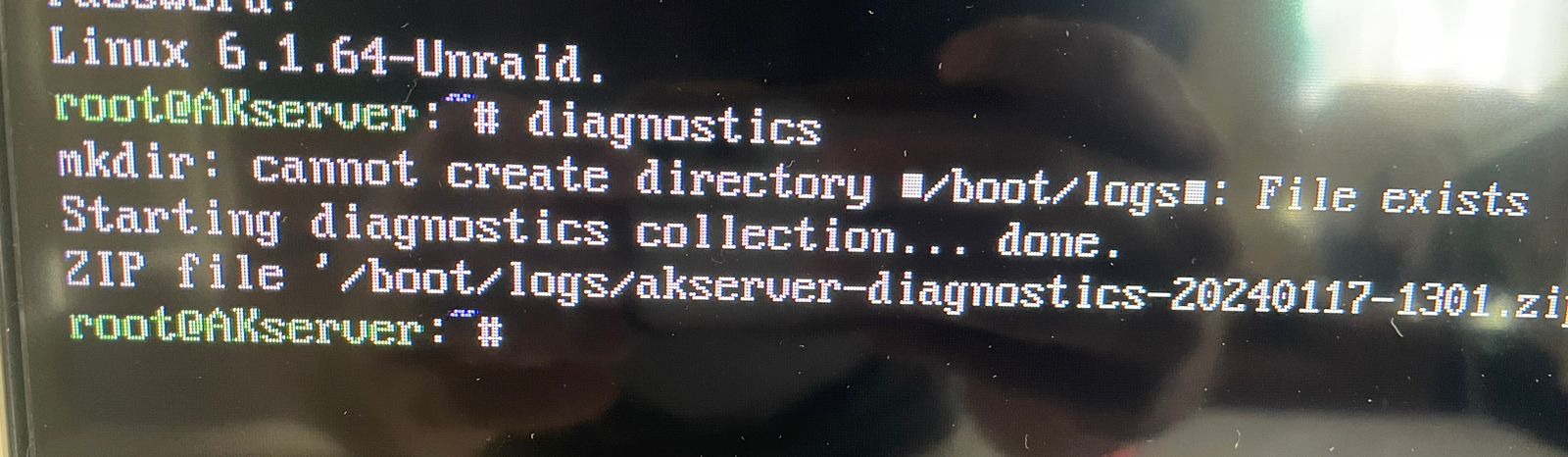

I tried typing diagnostics with a keyboard attached to the tower again but same result. The screen says the file is saved but there is none in the flash. Pic attached.
