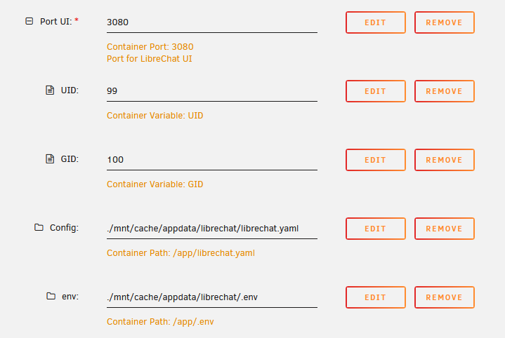

January 28, 20251 yr So I currently run this through huggingface but I'd prefer to run this docker on unraid to self host. I'm wanting to use this config.yml file https://raw.githubusercontent.com/LibreChat-AI/librechat-config-yaml/main/librechat-hf.yaml however I'm not sure where to place it given the docker template doesn't create an appdata folder like most do. Are you able to assist?
February 2, 20251 yr What I did was create my own appdata folder /mnt/user/appdata/librechat, and inside that, I created librechat.yaml Within the current docker config in Unraid, I then mapped the file as per this method - note the . infront of the file path so that it doesn't try to use a directory:
February 12, 20251 yr I have added the .env file as well, so I don't have to add a gazillion environment vars to the docker config in Unraid. Seems to work perfectly. I migrated all the docker template's settings to the .env file, so only this is left: Edited February 12, 20251 yr by Ruuddie
