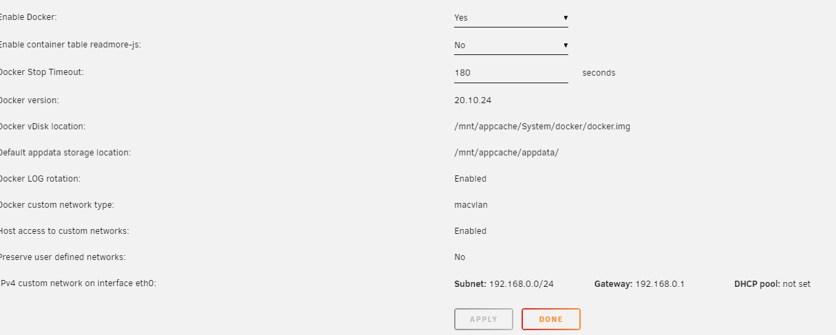

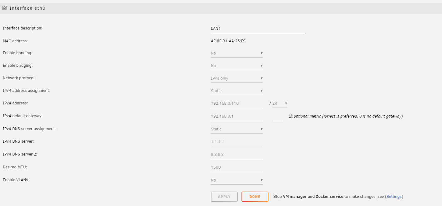

So ive switched yesterday (while updating to 6.12.6) to macvlan following this "tutorial":
https://docs.unraid.net/unraid-os/release-notes/6.12.4/
For those users, we have a new method that reworks networking to avoid issues with macvlan. Tweak a few settings and your Docker containers, VMs, and WireGuard tunnels should automatically adjust to use them:
Settings > Network Settings > eth0 > Enable Bonding = Yes or No, either work with this solution
Settings > Network Settings > eth0 > Enable Bridging = No (this will automatically enable macvlan)
Settings > Docker > Host access to custom networks = Enabled
Is there anything other i should have done? Most dockers are in bridge, some are in br1, i have a VM (which wasnt turned on)

To use mcvlan you need to disable bridging for the interface docker is using, if it's eth1 disable bridging for that NIC.

11 hours ago, NewDisplayName said:
ONLY in macvlan is it crashing,
AFAIK no one else has macvlan issues as long as bridging is disabled, which according to your screenshot it is, and if macvlan was the problem I would expect to see some macvlan related call traces in the syslog, there is nothing in the syslog you posted, so the problem may not be that.
Okay, can you tell me which commands i can run to see in ssh if its using macvlan correct?
does that help?

Post the output of
docker network ls
14 minutes ago, JorgeB said:
Post the output of
docker network ls
Does that look correct?
root@Unraid-Server:~# docker network ls
WARNING: Error loading config file: /root/.docker/config.json: read /root/.docker/config.json: is a directory
NETWORK ID     NAME                   DRIVER    SCOPE
f2549c38417d   bridge                 bridge    local
eee258978ef2   eth0                   macvlan   local
ba7d287b5243   filesharing            bridge    local
c426a08021c6   host                   host      local
d2b93c4c6a03   none                   null      local
a6339c7cf36b   watchtower_default     bridge    local
9dc3c3d319c7   watchtower_immich      bridge    local
514fa62878e3   watchtower_webserver   bridge    local
04fb1877a554   webserver_webserver    bridge    local

That looks correct to me, the traps segfault should be OK to ignore, I'm used to see that in various diags.

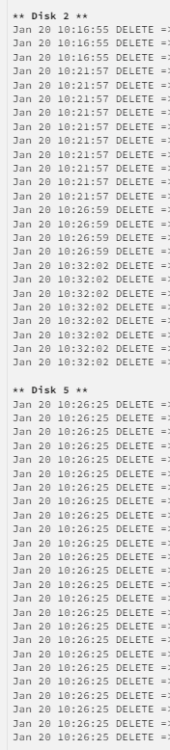

I also noticed drives dont spin down, it was set to 1h (since 9am, around 1,5h  ago i changed it to 15min setting.)
I enabled the activity plugin, and it says there was activity
DISK 1,2,5,9,10
Wasnt that fixed years ago? As i startet my experiment, i spun down all drives. And unraid is like yeah, nows a good time for some smart data reading...?

edit: another hour later, still not a single drive spun down, as per file activity still: 1,2,9,10
