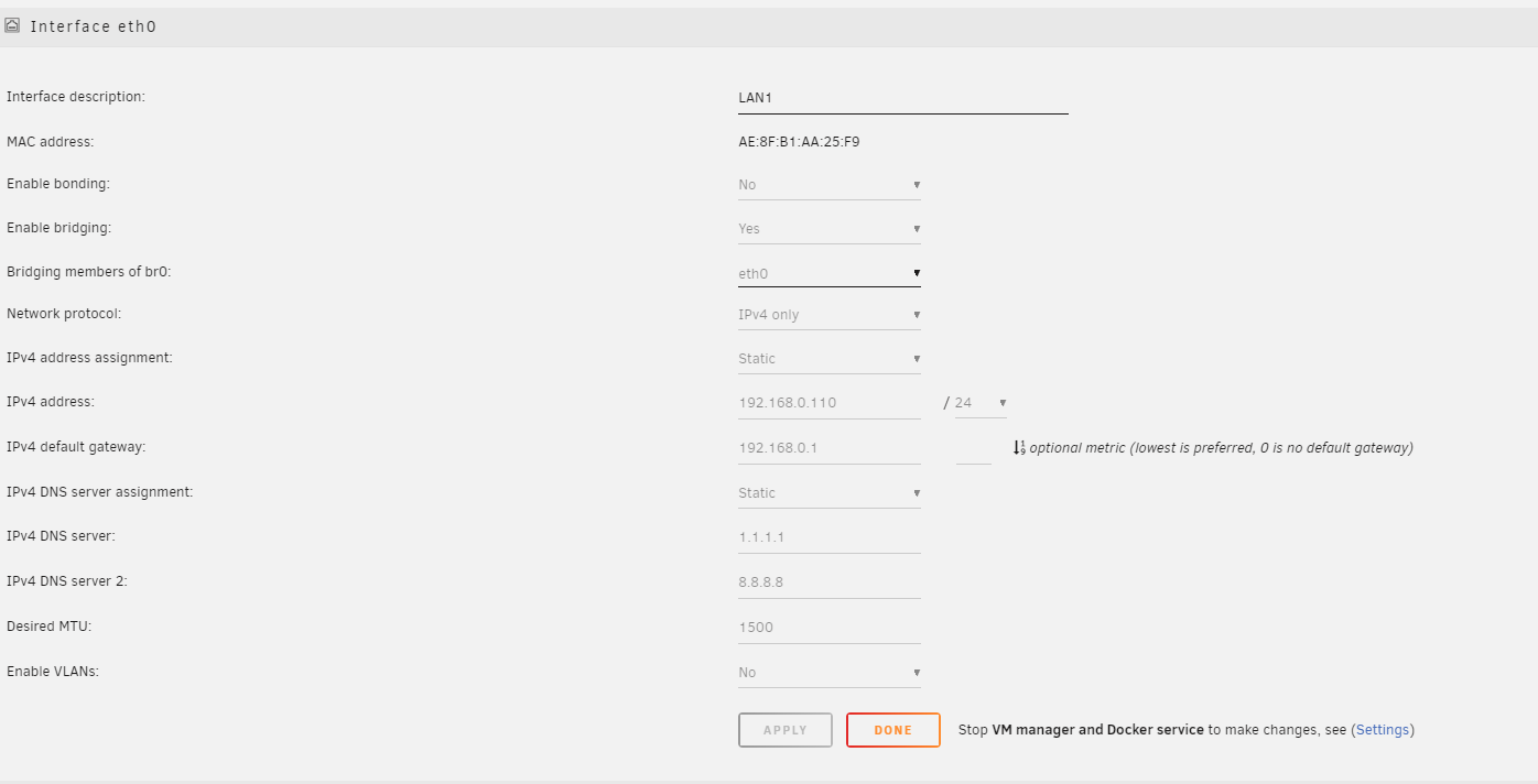

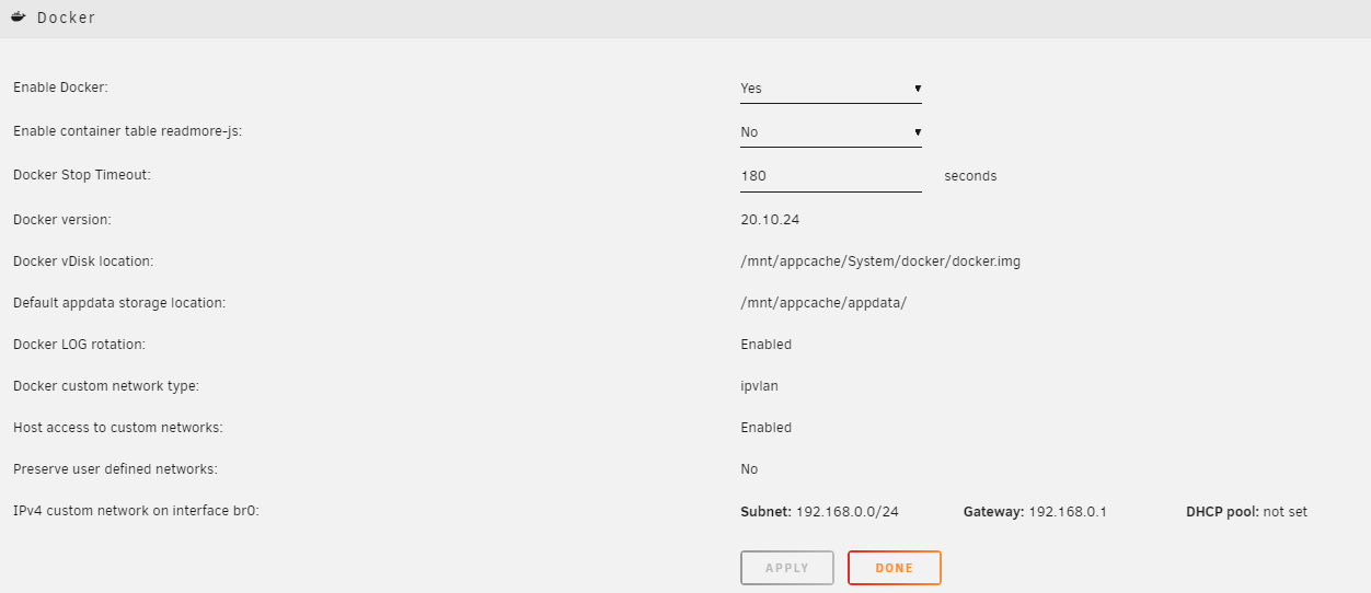

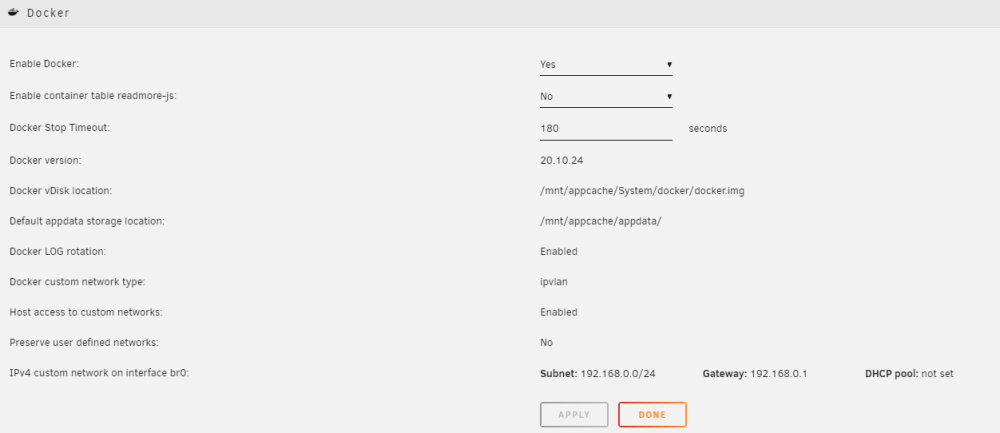

root@Unraid-Server:~# docker network ls
WARNING: Error loading config file: /root/.docker/config.json: read /root/.docker/config.json: is a directory
NETWORK ID     NAME                   DRIVER    SCOPE
9c02e6451544   br0                    ipvlan    local
ffa2b65b637b   bridge                 bridge    local
ba7d287b5243   filesharing            bridge    local
c426a08021c6   host                   host      local
d2b93c4c6a03   none                   null      local
a6339c7cf36b   watchtower_default     bridge    local
514fa62878e3   watchtower_webserver   bridge    local
04fb1877a554   webserver_webserver    bridge    local
does that look correct?
As far as I know that combination follows the Limetech guidelines.   I expect @JorgeB will chime in if there is anything obviously wrong.
