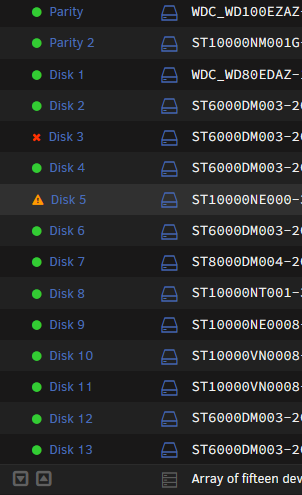

device disabled contents emulated after reapir
Hi so I had a crash and when I turned everything back on disk 3 wasa dead.
Now I need to say I was rebuilding disk 5 during this. So maybe it is a disk dieing but its had a clean bill of health in all my tests.
I have run repair but when it all starts back up it still says "device disabled contents emulated"
Help please

I just noticed disk 5 is also unmoutabel and its the one I have been rebuilding.
I just noticed this also. So you are rebuilding an unmountable filesystem to disk5.
Normally we try to repair the filesystem before rebuilding, especially if rebuilding onto the same disk. Is this the same disk or a new disk you are using for rebuild?
I was rebuilding a healthy system.
Disk 5 was a 6TB -> 10TB upgrade started yesterday.
The box froze today shortly before my post and on reboot itsaid disk 3 was unmountable.
As it started in normal mode before i got to the GUI it must have restored some contnet to it.
So I need to get disk 3 mounted again and then restart the rebuild of Disk 5
So do you mean this was a new disk? Do you still have the original disk with its contents?
Check filesystem on disk3 and on disk5. Be sure to use the webUI and not the command line. Capture the outputs and post them.
it was a new disk. I have the old disk next to me.
