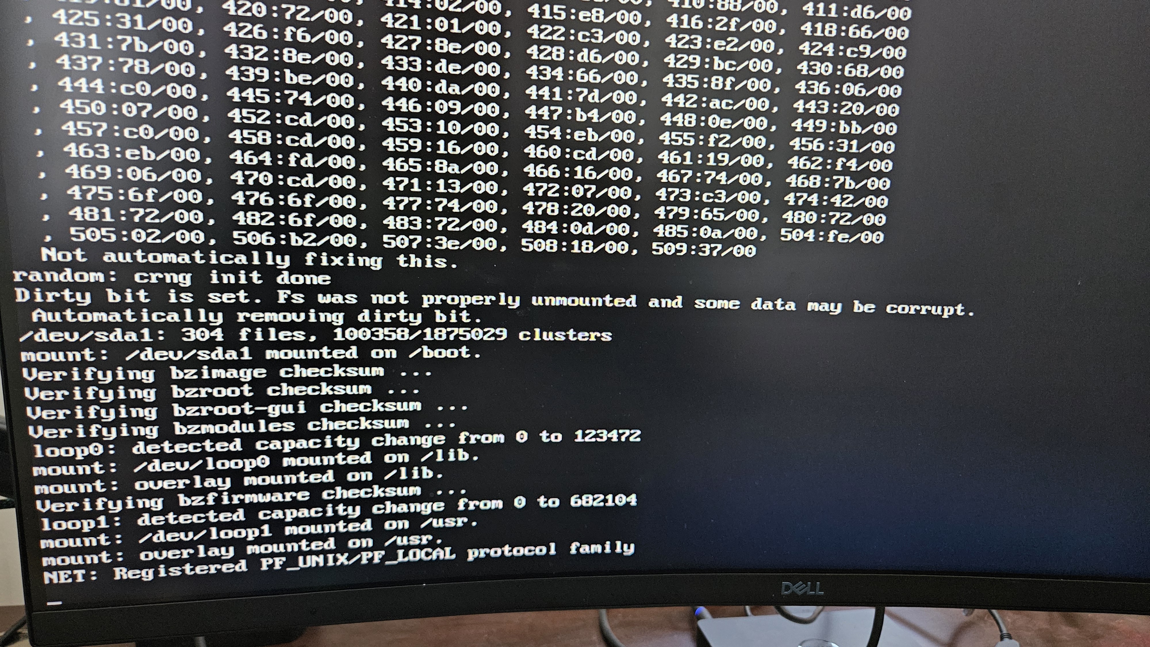

My unraid USB is succesfully getting to the boot screen where I can choose to run in GUI or without GUI etc and in safe mode. But i've tried all options and it doesn't load. Seems to get stuck as shown in the screenshot.

Put the stick into another computer (eg: Windows) and run chkdsk on it
I ran the checkdisk utility in windows 11 but I don't think it found any errors. Booted up and still shows the same screen. I also see the machine in my router list but can't access it
Try recreating the flash drive, if the same try booting with a different one using a stock Unraid install, no key needed, just to see if it boots.
So I backed up my USB and flashed a fresh unraid using the unraid USB creator. Then I copied the config folder over to the USB stick and I was getting the exact same error.
