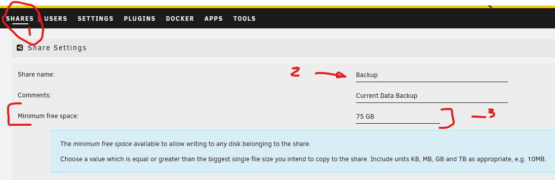

Make sure that you  have set the following parameter:
Otherwise, the copy may fail if the file won't fit into the space available on the disk chosen as the target.
This setting is available for both Disk Shares and User Shares.  Set the parameter for the type of transfer being done.  (Most likely---  User Share...)
Thanks Frank1940 will make sure when I do the copy to unraid.
