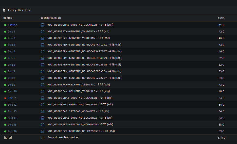

Hello all, I've got two 10TB drives that have failed, the first is Parity 1, and the other is drive 11. I couldn't find any 10TB locally, but ended up with two 12TB drives.  Is there a way for me to replace the parity drives with the new 12TB and then use the existing remaining good parity drive for the drive 11 replacement?  Does the Parity swap procedure work with multiple failed drives?  Screenshot and diags attached.
raptor-unraid-diagnostics-20240118-1631.zip
Solved by JorgeB
10 hours ago, JorgeB said:
I would add new parity1 first, then do a parity swap for the other disk.
Thanks, i'll give this a shot.  Appreciate the reply.

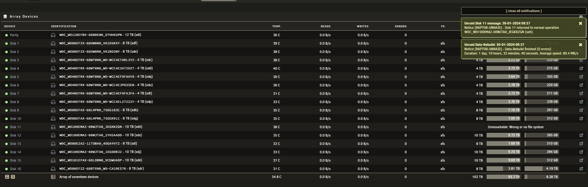

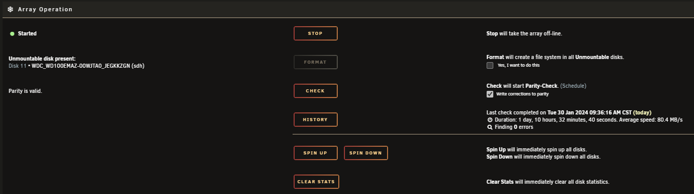

All drives have a green dot, but the rebuilt drive shows "Unmountable: Wrong or no file system"  Do I need another reboot, or do I need to format the unmountable disk?
raptor-unraid-diagnostics-20240130-0937.zip
Check filesystem on disk11, run it without -n.
P.S. several disk related issues logged, look like a power/connection issue, PSU could be on the way out.
Thanks for the guidance.  Looks like it made some changes.  Attached is the results.
diskcheck_output.txt
Disk is mounting now, check contents, also look for a lost+found folder.
It is mounted, and there is a lost and found folder with tons of files and folders.  Guessing there's not an automated way to get those back where they were?  Can I use something like krusader to move them without too much issue?
