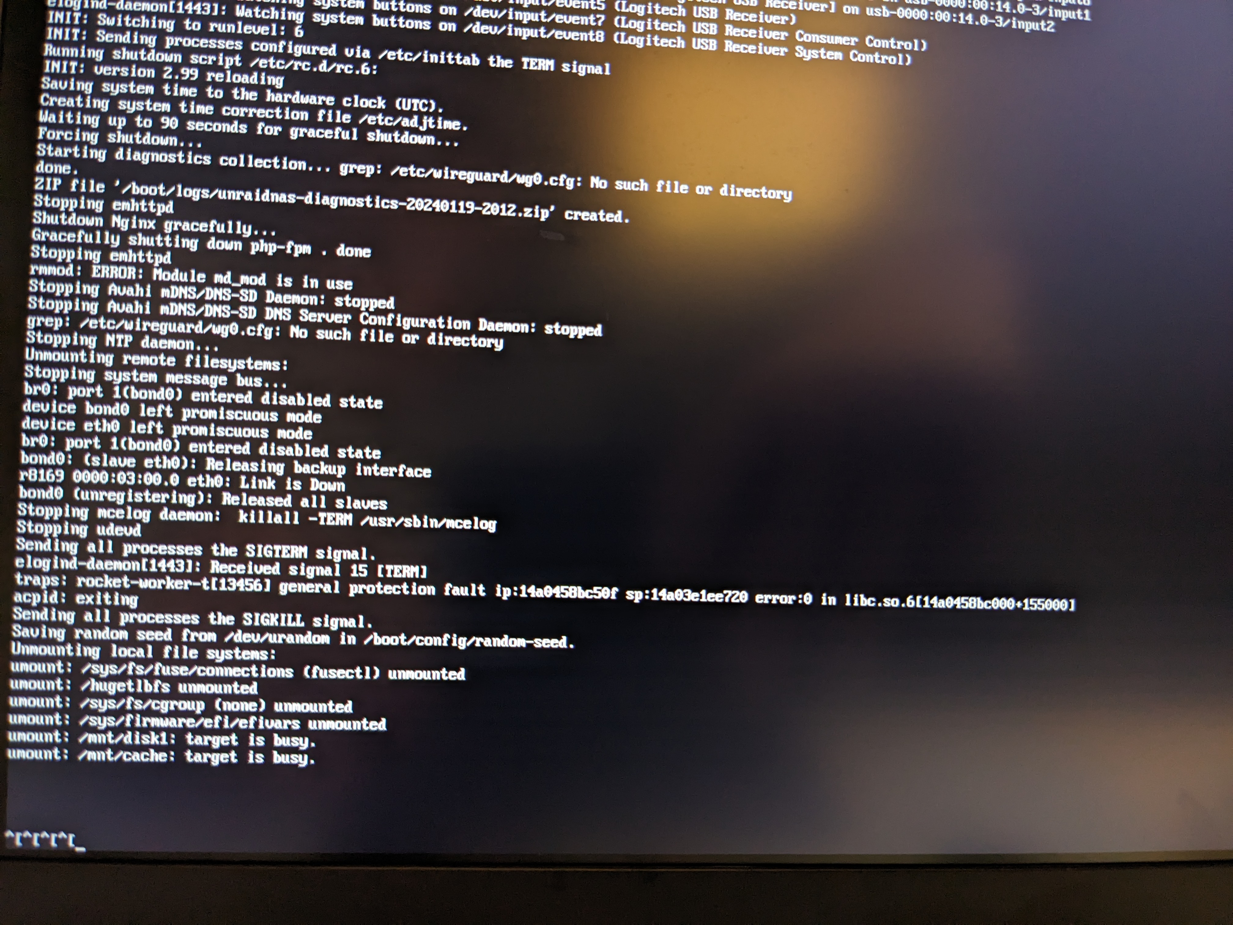

There is another possible hint though - I plugged in a monitor hoping that there would be some extra info that's not in the syslog. When I was rebooting to access memtest the server became unresponsive again, and it was stuck on unmounting disk1 and cache with "target is busy". I still couldn't SSH at that point to see what was using the disks though.
