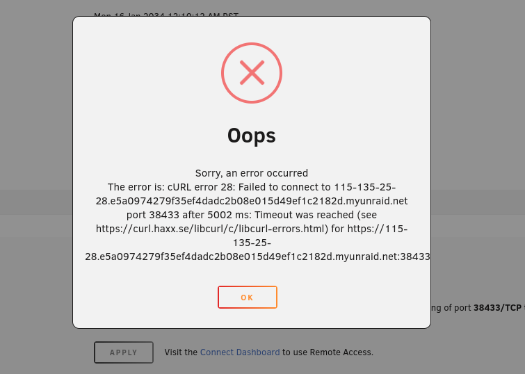

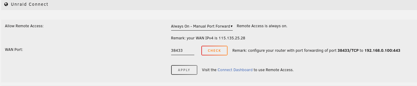

I have followed the guide to set manual port forwarding (always on) but when comes to checking, i got this error and unable to remotely connect

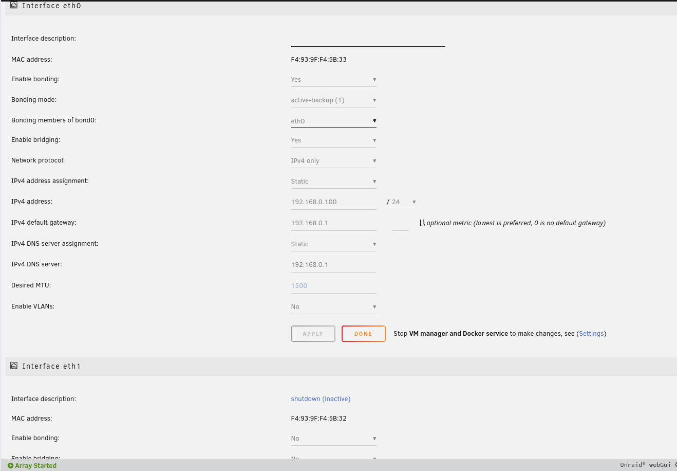

network setting removed eth1 as using eth0, set static ip

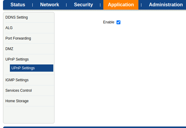

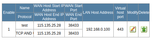

my router has port forwarding setting set and upnp enabled

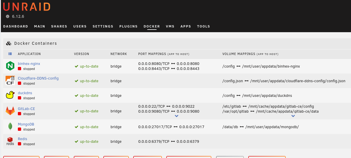

my docker has removed most of app and leaving these apps on hold
