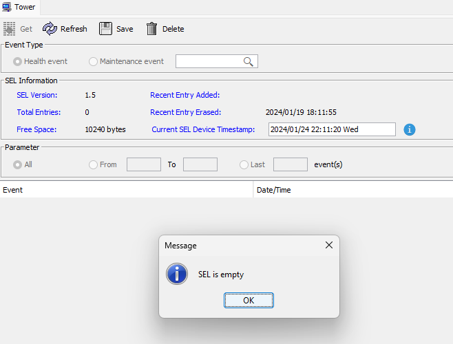

I am running it headless, logging in via IPMI gives me nothing.  Nothing in the IPMI Logs
This was a Board/CPU/Ram replacement of a SuperMicro X9 based system.  When the X9 would crash it at least would have information in the IPMI Logs.  I am not even seeing events for Power On/Off.  I did check the BIOS to see if it is enabled and it looks like it is.
