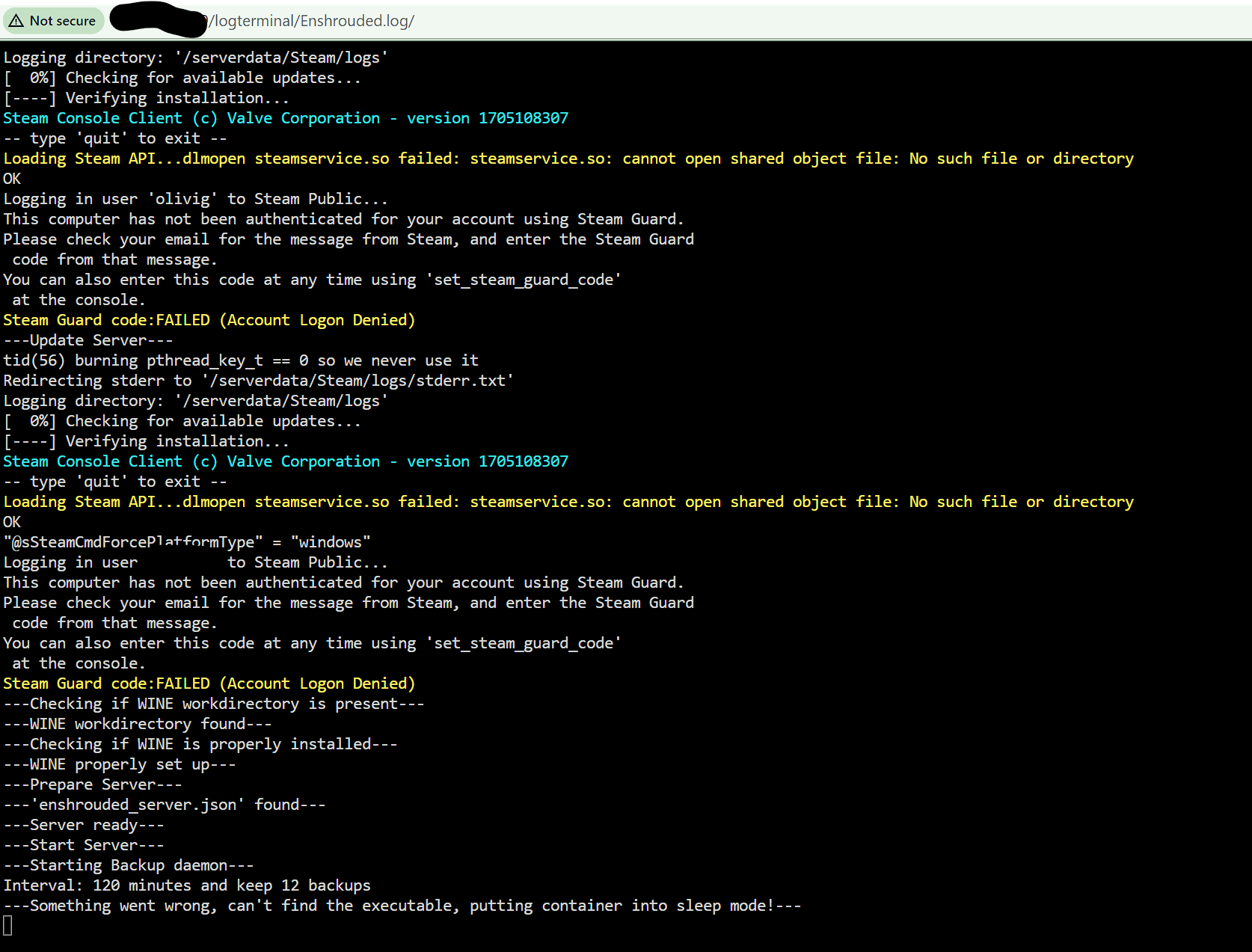

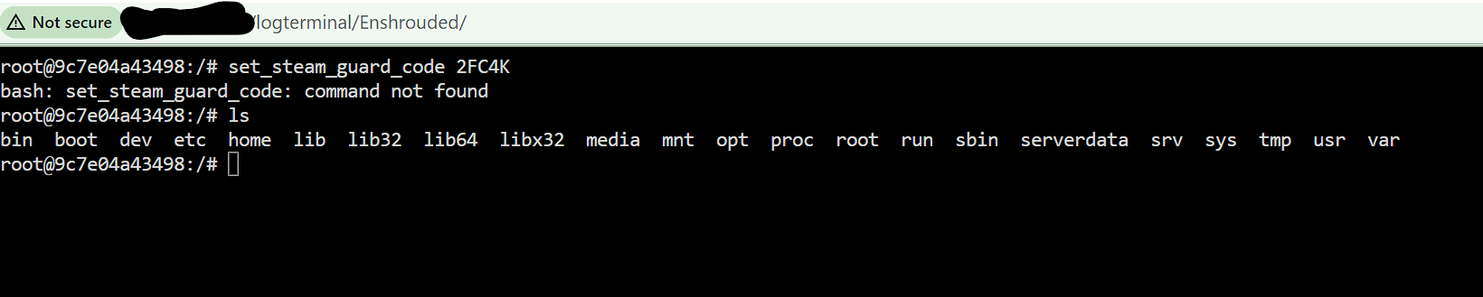

Olivilo Posted February 13 Share Posted February 13 (edited) Hello everybody, i am just new to Unraid and learning still. I just tried to install a Gamemap Hosting Docker from the game Enshroudet. I enterd my Login and pw but it seems it does not start the download from Steam it seems i need to enter the code from Streamguard in a console but wherever i start the console the system tells me there is not sutch a command it knows. where is this command hidden? and btw how do i change the Name and PW of the Map? Thx everyone Edited February 13 by Olivilo Quote Link to comment
Nodiaque Posted February 13 Author Share Posted February 13 1 minute ago, Olivilo said: Hello everybody, i am just new to Unraid and learning still. I just tried to install a Gamemap Hosting Docker from the game Enshroudet. I enterd my Login and pw but it seems it does not start the download from Steam it seems i need to enter the code from Streamguard in a console but wherever i start the console the system tells me there is not sutch a command it knows. where is this command hidden? and btw how do i change the Name and PW of the Map? Thx everyone I don't know what gamemap hosting docker is. To run the server, all you have to do is install enshrouded, let it start (take a while). Once it's completely finish (you will have enshrouded log files and configuration file in the folder), you can stop and edit the config file. Quote Link to comment
Olivilo Posted February 13 Share Posted February 13 (edited) 18 minutes ago, Nodiaque said: I don't know what gamemap hosting docker is. To run the server, all you have to do is install enshrouded, let it start (take a while). Once it's completely finish (you will have enshrouded log files and configuration file in the folder), you can stop and edit the config file. I dont mean a different map sorry no native speaker. standard map but it seems that the dockes installation sice it uses my login credentials need to get over Steamguard, in the Installatin is written i need to use a command with the Key i got in the email but as you can see it does not work, so i need to know where i exececute it. Next is that only with commandoline to seek some config files in a directory structure i am not firm with i seek myself dead seeking them so if you know in what directory this config file is plz tell me 😄 Edited February 13 by Olivilo Quote Link to comment
Nodiaque Posted February 13 Author Share Posted February 13 8 minutes ago, Olivilo said: I dont mean a different map sorry no native speaker. standard map but it seems that the dockes installation sice it uses my login credentials need to get over Steamguard, in the Installatin is written i need to use a command with the Key i got in the email but as you can see it does not work, so i need to know where i exececute it. Next is that only with commandoline to seek some config files in a directory structure i am not firm with i seek myself dead seeking them so if you know in what directory this config file is plz tell me 😄 Do not use you steam account, leave this blank. Quote Link to comment

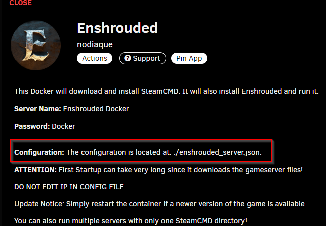

Nodiaque Posted February 13 Author Share Posted February 13 1 minute ago, Olivilo said: ok i deinstalled and installed this docker fresh with no credetials from me and i wait now until all is installed in Background ... btw where do i find the config file to change Name and PW of the server ? In the folder where your path is mapped when you created the docker. Quote Link to comment

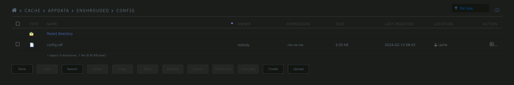

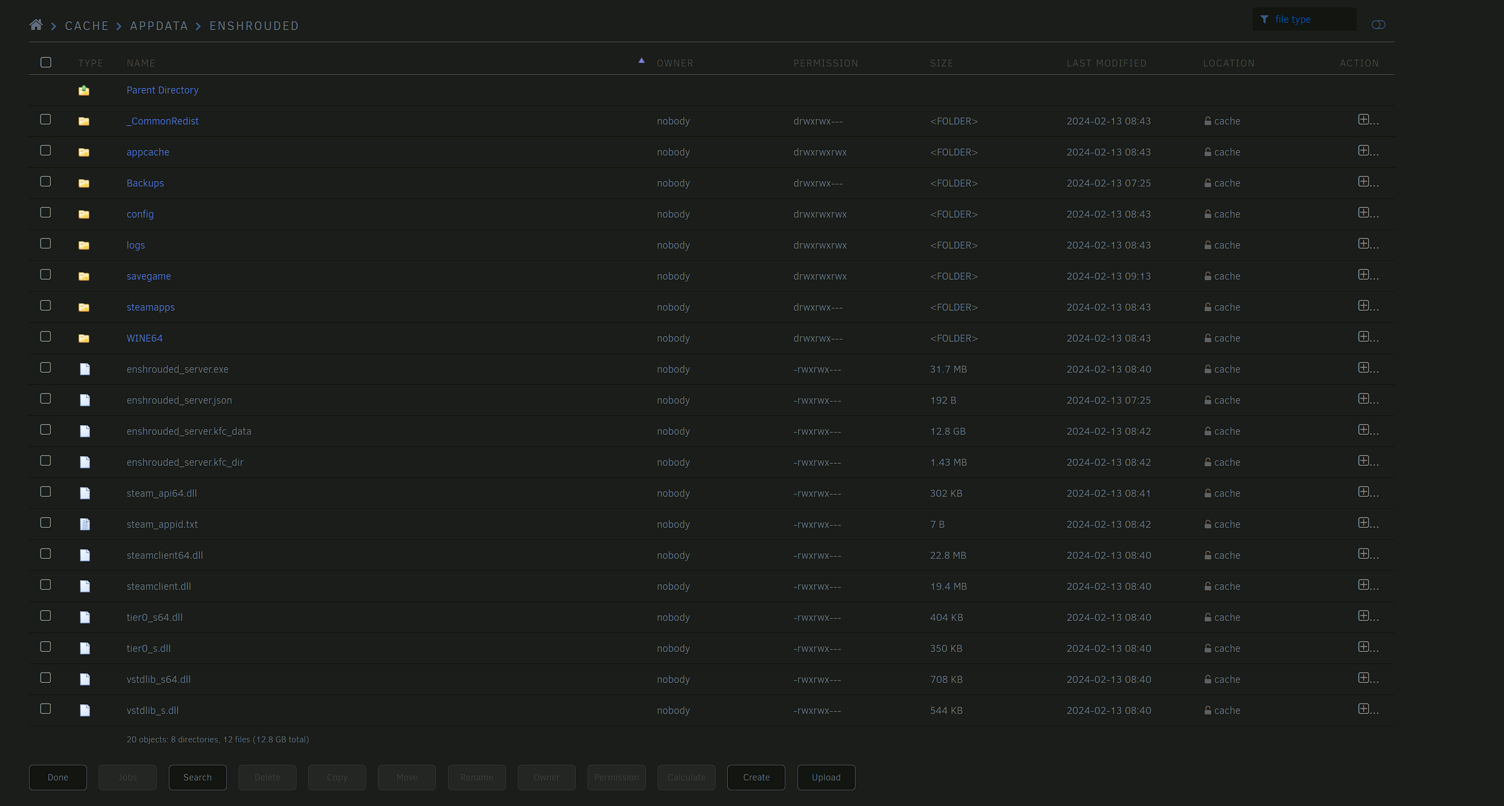

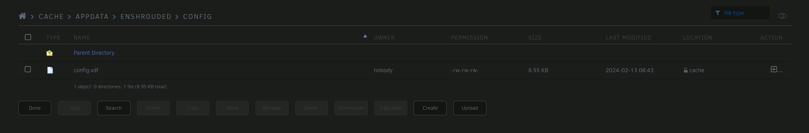

Olivilo Posted February 13 Share Posted February 13 i found the directory over the file manger under caches and appdata enshroudet i think its not in teh steam directory in this enshroudet i have allredy different config files but i cant rightklick edit them i dont know any command line editors for linux sry Quote Link to comment
Nodiaque Posted February 13 Author Share Posted February 13 1 minute ago, Olivilo said: i found the directory over the file manger under caches and appdata enshroudet i think its not in teh steam directory in this enshroudet i have allredy different config files but i cant rightklick edit them i dont know any command line editors for linux sry You can check permission on your share and your file. Normally, the user nobody which is default unraid have access and you should be able to edit like any other file in appdata. If not, you might have a permission issue. There's multiple app you can use to edit from the community app like code-server and such. Quote Link to comment
Olivilo Posted February 13 Share Posted February 13 ok i can download a file look at local Editor att it and upload the new one thats ok but where is thsi confiog for the servername and Logincreds ? Quote Link to comment
Nodiaque Posted February 13 Author Share Posted February 13 It's all in the config file once the server is created. If it's blank, you didn't had the permission to read the file when you copied or the server didn't start properly. Quote Link to comment
Olivilo Posted February 13 Share Posted February 13 the server Jason is nothing like pw or name in it Quote Link to comment
Nodiaque Posted February 13 Author Share Posted February 13 (edited) unsure of you checked the documentation in the Community App page Config file should have only like 8 entries in it. If not, stop, delete, start, wait for it to be created, stop then edit. Edited February 13 by Nodiaque Quote Link to comment
Olivilo Posted February 13 Share Posted February 13 Ok i could mange to edit this file with the help of Krusader App i just needet time to find the right directory and to open and change this jason was easy thx for help sry tat i take so log i am a bit ill today Quote Link to comment
