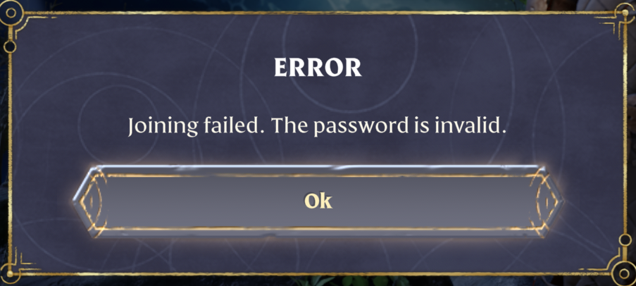

I just set up my server yesterday and it was working perfectly (except refusing to take my save from my co-op world but could work around that).
However, today I can't connect to the server any more, just getting this error message in the game even though I'm 100% sure the password is correct
and with this log output from the server
[I 00:05:31,122] -------------- Session ----------------
[I 00:05:31,122] Machines:
[I 00:05:31,122]   m#0(128): up 0 (0), down 0 (0), remote 0 (0), limit 256, lost 0, ping 0 ms, EstablishingBaseline
[I 00:05:31,122] ---------------------------------------
[I 00:05:46,533] [online] Session accepted with peer (steamid:[redacted])
[I 00:05:46,533] [online] Added peer #0 (steamid:[redacted])
[E 00:05:47,114] [online] Begin auth session with peer #0
[I 00:05:48,413] [online] Client '[redacted]' authenticated by steam
[W 00:05:48,454] [session] Unable to find machine for peer 0.
[W 00:05:48,454] [session] Could not store acknowledge of packet id: 100.
[I 00:05:48,485] [online] Disconnecting peer #0
[I 00:05:48,486] [online] Removed peer #0
Anyone have any tips?
Edit:
This issue was caused by the config file getting corrupted in some way by a backup script. Removing the file, letting it generate on server start and then re-entering all the settings fixed the issue temporarily.
Edited by Gronsak
Solution found
Did you check the config file to be sure it wasn't erased? This seems like a configuration problem.
If it continue, you might need to check on the official game forum for support on the server itself.
Yeah it's all still there and it all worked the day before and still no luck after a couple of days... The only info I could find refers to adding a Default user group but that didn't make any differens but I'll see if I can find any clarification on their forums
Figured it out, it was indeed the config file. While it looked fine on visual inspection, if I removed it and re-entered all my settings into a newly generated one it all started working again.
The issue seems to have been some kind of corruption occurring when appdata backup ran during the night because it was back the day after. For now I've turned it off for the Enshrouded Container until I have time to do some troubleshooting and implement the propper file whitelist so it only touches the backups and nothing else.
Ah it did happened in the past with other game server (conan exiles). What I do now is I have a custom script that run 5 minutes before appdata backup that shutdown the docker (but using rcon and sending a shutdown command directly to the game server). This way, I can also send a 5 minutes warning before shutdown as a broadcast to all users. This allow me to have a safe shutdown. And in appdata backup, I have a script ran at the end of the run to start back the dockers.
Yeah it seems like it's just the container stopping/restarting that does it since if I run docker restart Enshrouded_Proton yields the same issue... Does enshrouded support rcon? can't find any documentation around it in my googling. is there another way of doing a safe shutdown?
