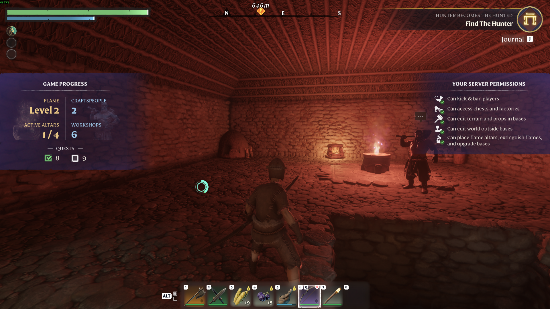

Any idea what im doing wrong here that would cause enshrouded to not read my JSON file that i edited? It didn't create another one, the only json file is the one i sent, but it does not want to read from it and retains all the default settings. Here is the json i sent with passwords and details edited from the original text.enshrouded_serverEXAMPLE.json
I've also included a screenshot of the permissions menu as well, which appear fine to me. image.png
Any idea what im doing wrong here? server runs, game plays, things are golden, but i can't change a single setting for some reason. We are running on default user names and passwords because it won't accept any changes i make to the JSON. What gives?

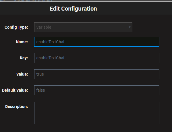

Setting variable in the docker template won't change anything. These are docker variable that then are environment variable for the OS inside docker. Unless a script is using them (there's none), these won't affect anything.
The problem is really with the fact that right now, you have 2 different copy of the file on 2 drive (dockerconta... and cache). This shouldn't happen and is bad.

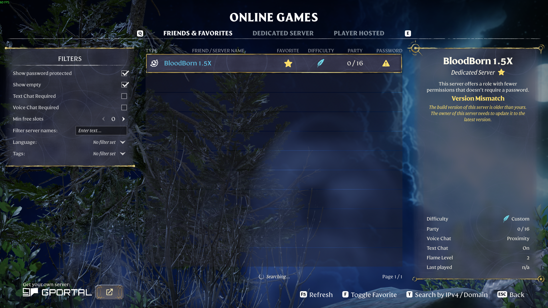

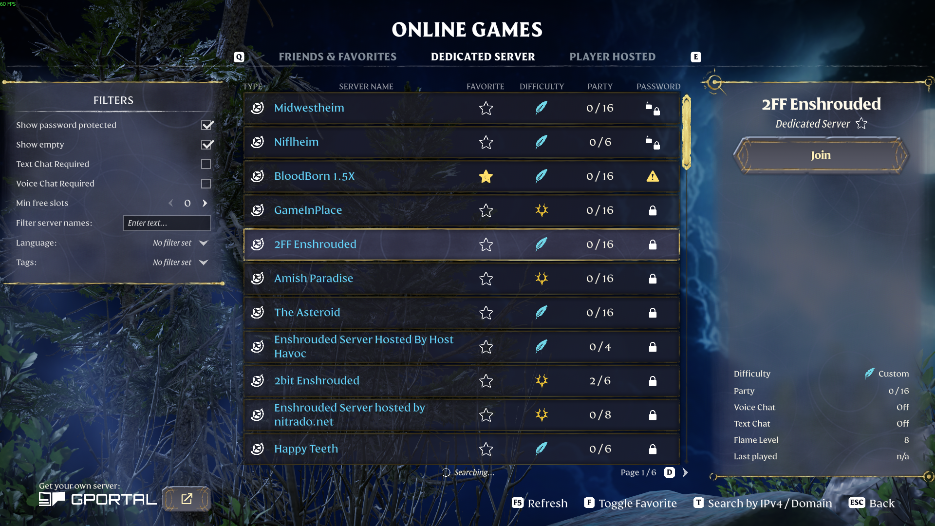

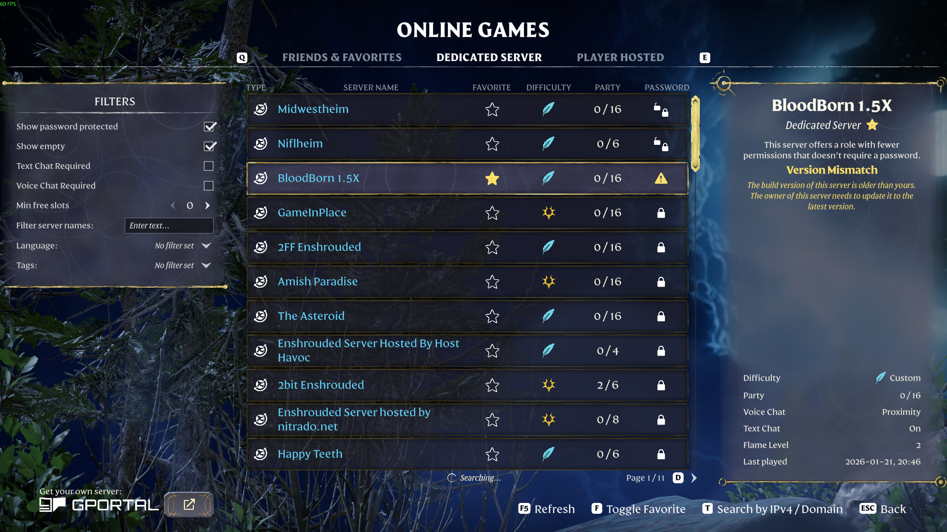

Thanks for the tips @Nodiaque . I made some changes, got everything working, and then started playing and everything has been fine.
However, a new patch has hit the game and i once again run into the original error i had way back when. I now have version mismatch error on my server, and i can't seem to get it to update.
So far i've restarted the server which should theoretically update it, but i still am on an old patch.
I've also, while it was running, logged into the steamcmd console for the docker container and tried to run app_update 2278520 validate and even got a little bit to download from this, but still no version update.
At this point im trying to figure out how to do this update with the container offline, but im a total noob in CLI and unraid and trying to figure that out. Until i can, i figured i would ask, if Enshrouded does a game update and my server does not update, and rebooting it does not update it, what is the best steps to take to get the version back up to date?
Version mismatch from the server or when you try to connect to the server? This happen sometime when the server get update either before or after the new game version release. I've had that with various game. The server might not have the new version available yet.
You can try just to test to make a backup of the game folder and start with an empty one. If you still get the same error, it's either because the new server version didn't get release or the game client wasn't release yet.

I was not able to get this fixed by force updating the docker container or any update process at all. I would go to the server list and find my private server, as nerd demonstrates above, and it would give version mismatch. My client is updated to the latest version of enshrouded, but the server is not. When i check the logs i can see the version of the game server is out of date, and no amount of updating via restarts or steamcmd was getting me the new files for the enshrouded server.
I did fix this by just giving up, changed the name of the ensrhouded server, backed up my game files, backups, and json. Then created a whole new enshrouded server in docker using the original server template, transferred over my game files, json, etc. When i launch the new server it does have the correct game version and correct files, fully working and can be signed into. So i have "solved" the problem for myself, but haven't answered the question of how to fix the docker container without just redownloading and rebuilding it.
So in my case, is just creating a full blown new docker container and transferring over the server world files the answer? Or is there a force validate/update process that i am missing?

ive deleted it and tired Enshrouded_Proton and Enshrouded tired perms chmod 777 and now ill start a new docker ill report back
not to be rude but installing a new one works, so it has to be something with your docker, it won't update must install a new docker and that means i lose everything
update, installing a new fresh docker runs fine, deleting all files from that docker and moving my files from my other docker, server miss match so yes this docker update problem! so there is 2 options! one just start fresh and new, or wait till its fixed i guess! i am not restarting!

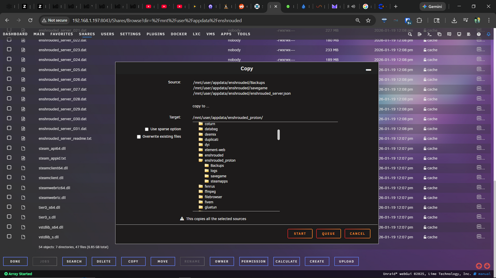

FIX!
1 delete Enshrouded_Proton NOT apdata!! keep that back it up!
2 stop docker
3 copy appcache, Backups, config, logs, savegame and enshrouded_server.json
FROM the older docker appdata to the new docker appdata! keep your old backup!
seems you only need, Backups, savegame, enshrouded_server.json image.png1 delete Enshrouded docker keep appdata!
2 backup Enshrouded appdata different location
3 reinstall Enshrouded read logs let it fully start,
4 stop docker, move Backups, savegame, enshrouded_server.json from the old working appdata!
5 Enjoy! Docker still needs fixed

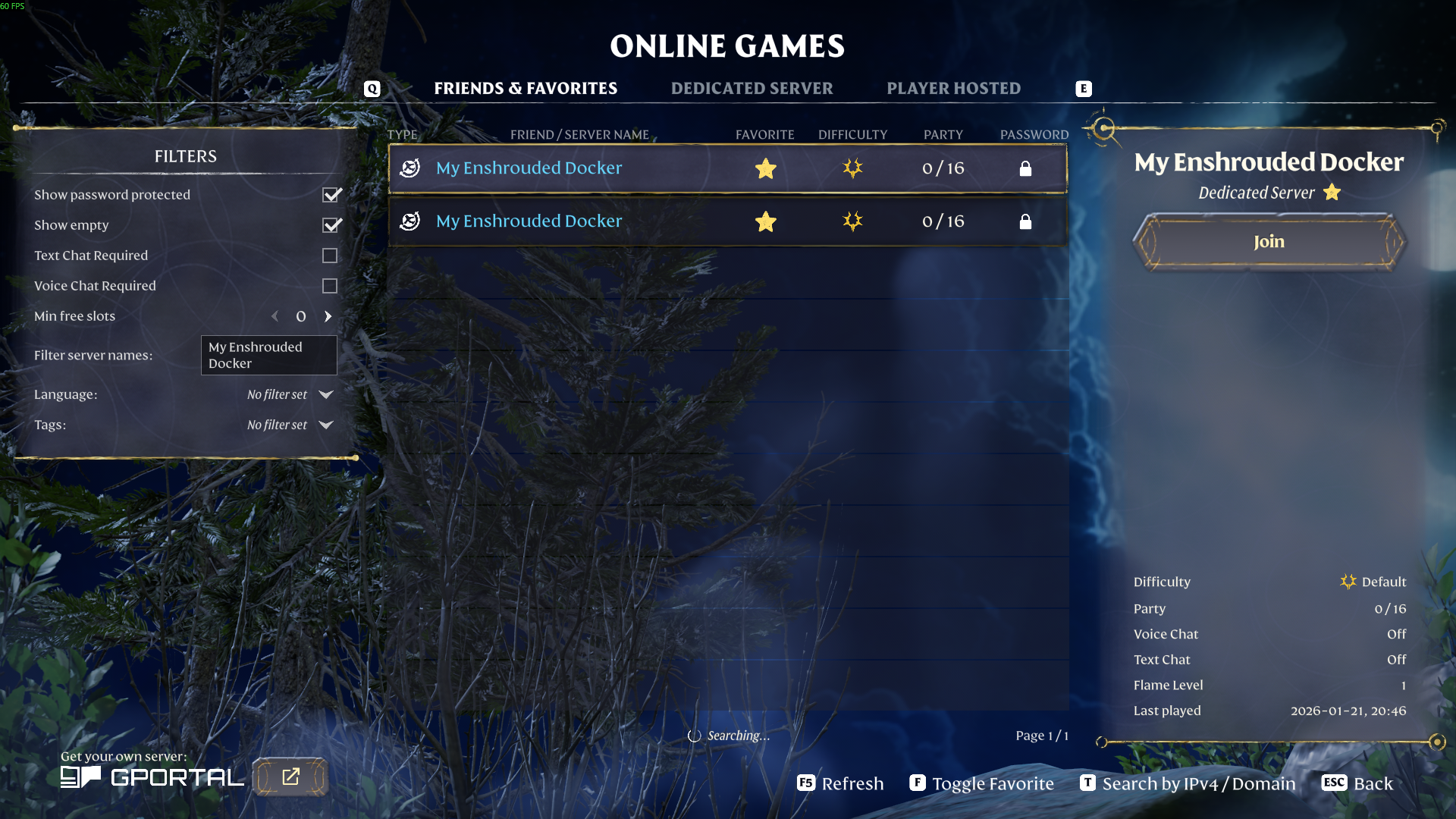

i think the showing 2 servers is a bug
but now i do have this problem, or bug
