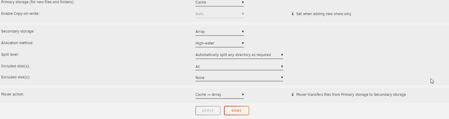

Thank you!  Can you screenshot where this cache=only setting is?  I saw posts about this, but I have no idea where to set that.
See the link above, now it's not called that, but all the settings are per shares, click on a share first.
So like this?  I have set this, ran the mover, and nothing changed.  Still at 100%, mover instantly stops.
I figured it out, I am an idiot.  I ran a Docker that downloaded 200gb of data without me realizing.  TreeSize helped me figure that out.  THANK YOU for all the help!
